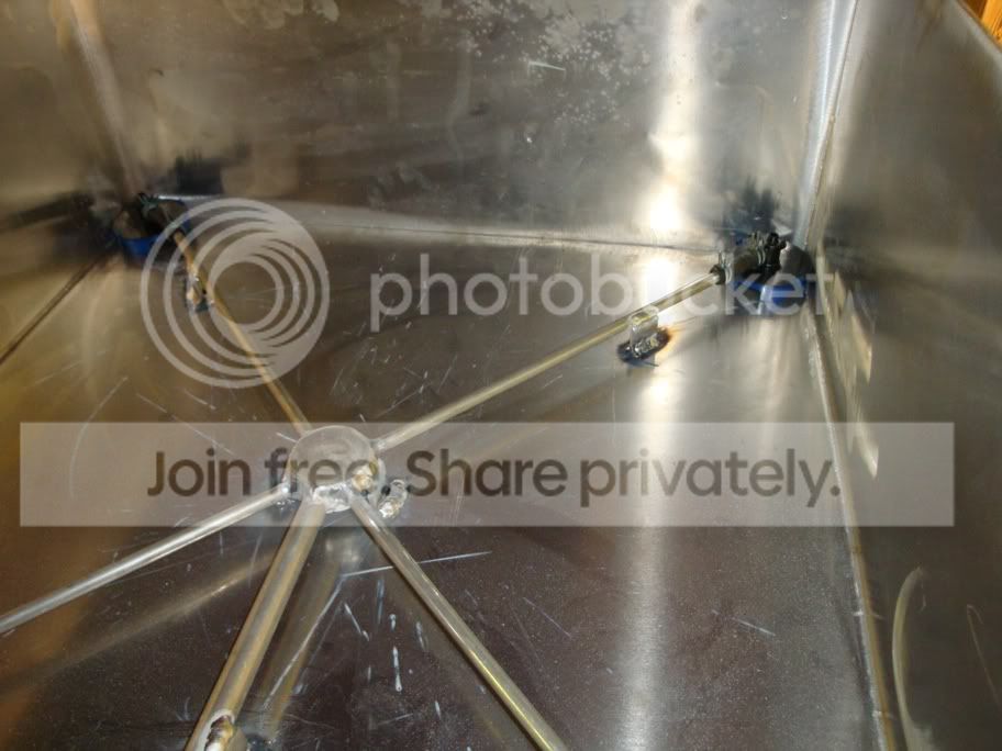

do you remember the one Kert did? i'm betting that worked nice.. maybe he'll post a pic of it...
I do remember that "gray water tank" he built, very nice.
Yep, even runs when its laying on its side. That much we know for sure.

I dont understan how does it keep from sucking air drom the tubes that are not submerged?
It's a check ball or something along those lines inside the pickups. When they aren't submerged they seal off.
those look like the Walbro pickups. Is that it Kert?
Those have a mesh on the bottom that basically acts like a screen on your window.
When it gets wet it will hold the liquid and form a barrier to prevent sucking air through it.

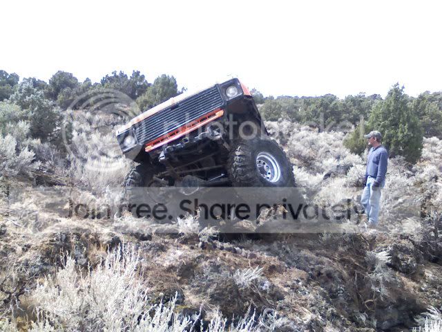

Okay just to venture another point here Dave although I was fairly diligent about making sure my tank was full when I went wheeling I never had a problem even with angles like this
although the snowmobile pickups would probably be good with what you have done
Eric, Horton is like no other animal. It does things that it just shouldn't be able to do.
Yep, that's the ones. Walbro.
