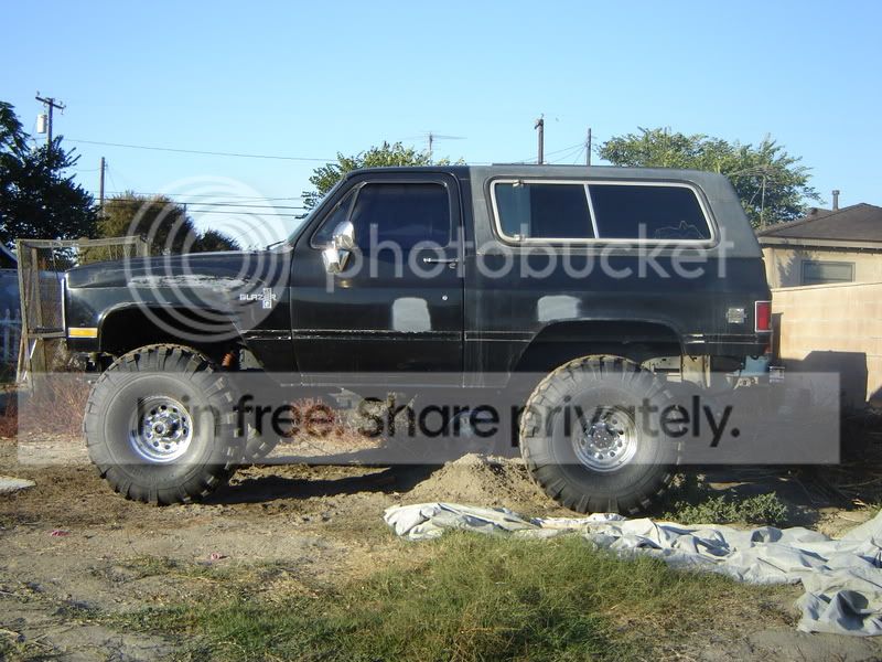

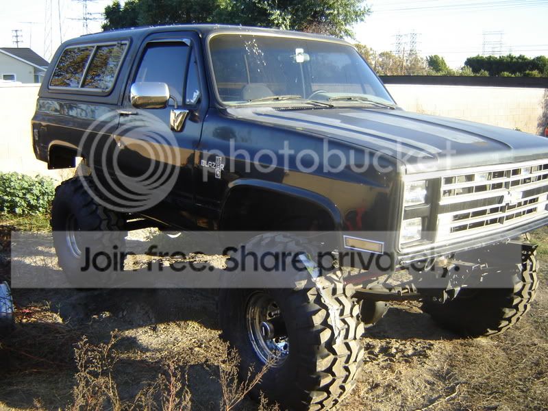

I did something similar to what DPI did, although I didnt really bother to strengthen the fender or roll a lip on it. I did however cut back to where the bottom of the floor line is at. It worked perfect because all I did was screw the innner fender back to the firewall, well its actually part of the floor board. If you got under there and looked around you will be able to get the idea. Let me see if I have any pics, if not I will take some. By the way I have about 6" suspension with a 1" body on 39.5's.

I kept my inner, however I cut right below the bolt that holds the inner to the cab. Cut it straight across... in the front im thinking of making a way to cut my second battery tray down and cut and stretch the inner front to go higher..... so instead of / be more of a ___

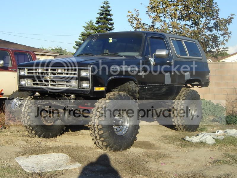

I cut the body an inch lower than I wanted finish and then cut slits upward to where I wanted finish and bent the fins in like an L and did a lot of big cutting on the inner fenders and joined the two together and had to put in some patch metal and a lot of welding. Here are some pics I found.
