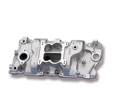

I finally installed my new intake manifold on my 305 yesterday. It is the Weiand Action+ with a 2in carb spacer. Wow what a difference the thing makes in throttle responce and power. I swear I gained 25hp over the stock manifold. The thing pulls real hard from about idle to 5200rpm. The only issues I am having with it is that the throttle bracket is not in the right place so the throttle cable is not long enough by 1/2 cm. So the cable puts on the throttle a little so it stays at 1200rpm at idle. I am having a new bracket from JEGS overnighted to me.
My other problem is that I developed a massive oil leak somewhere towards the back of the block. I thought it was valve covers, but unforunately it wasn't. I think it might be from the back of the intake, but I thought that any leaks on the manifold would cause a vacuum leak and not spew oil all over? I didn't use the little rubber pieces there, I used a nice bead of black RTV. So what are your thoughts?
Most likely your distributor gasket. I had the same exact problem when I replaced my intake gasket. I replaced my valve cover gaskets and that still didn't solve it. So I felt around back there and it was leaking right out of the distributor gasket.
maybe not enough RTV used. Leak of the crank case will negate any vacuum put on it by the PCV. So I'd pull it and redo the RTV job. Lose the 2" spacer man. Why have it? You have a torquey manifold with a piece designed to raise the powerband in the RPM range. If you insist on an open spacer go down to a 1" and your throttle will probably be long enoug.
I discovered that it was not the distributor gasket, but it was the rear of the manifold. I couldn't take the manifold off tonight for lack of time, so I put a glob a RTV on the back of the manifold and it seemed to help it. Not a perminate fix but at least it is not leaking all over my exhaust now. This whole month I am really busy so I am not sure when I can get to it to do it correctly.

Cool, I just found out that my oil leak is coming from the back of the intake :( That aggravates me. All that hard work, and now it has to be completely redone because I screwed it up. Oh well, at least the shop got it back in time...

dont screw with ordering intake gaskets from Summit, go to your local auto parts store, and buy whatever they stock. there's no advantage over stock with the Mr Gasket gaskets.
