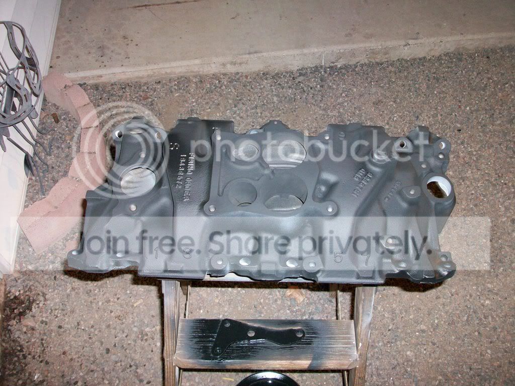

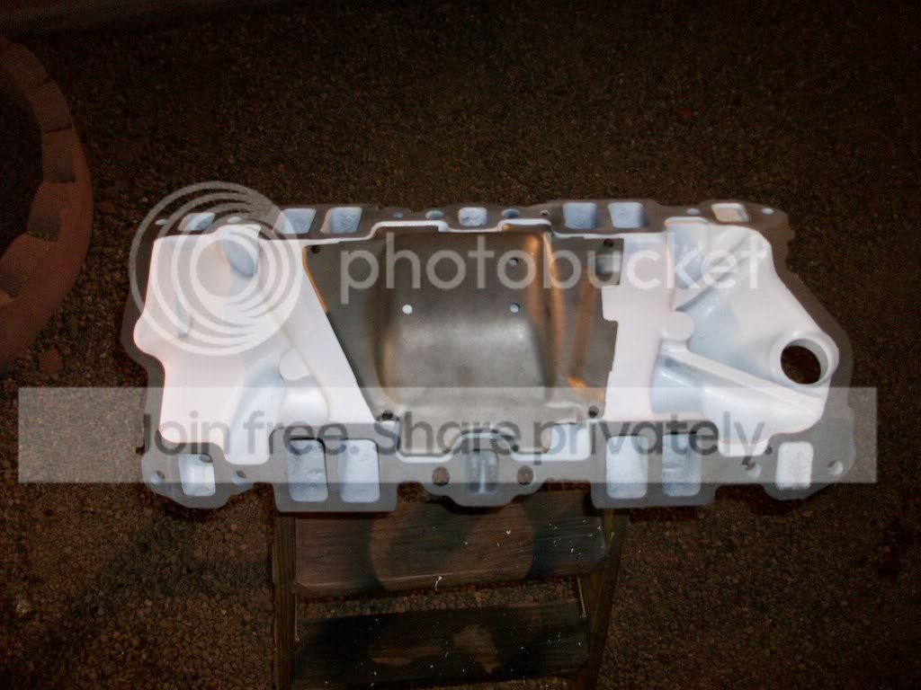

Use high heat and radiator paint from Krylon . White under the intake ( remove rivets on heat shield and reattach after ) . I used black on top side of intake.
Went a year plus with this in AZ , and the paint is still there , clean it very good so the paint sticks <-----
. PM Juanblazer for after pics , as this is his now and I removed it ( I m going TBI ) :D
