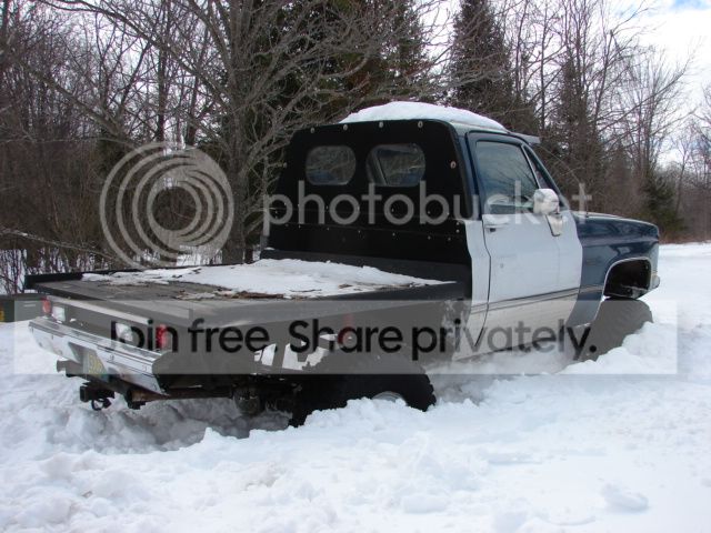

Someone has done this... i cant remeber his name at the moment. He has a whole wood bed and wood rear of cab. It looks pretty good too.

I saw a flat fendered Jeep at Thompson Speedways auto swap meet one year and a friend I went with came close to buying it--it was completely made of knotty rough cut pine!...fully funcionable and it was driven there,the guy wanted 500 firm for it...I almost ended up driving it home! :eek:..but my friend decided tp pass on it..you wouldn't know it was all wood till you got right up close to it...it was camoflauged so it looked like metal ,till you saw the knots in the boards up close!..
I see nothing wrong with using plywood or wood on that Jeep,if its just a plow truck and a runabout for local trips,who'd really know when it goes by you at 40 mph what exactly its body panels are made of?...I think the K5 custom bed and cab conversion looks cool too...maybe I'm just a hillbilly,but I kind of like "unusual" vehicles like these..pound for pound wood is stronger than steel,and I think it rots slower here than steel too!..

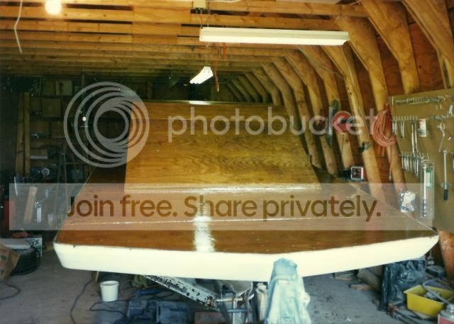

Did you do anything special to the wood other then paint it?
Your pics answered some questions I had regarding the floor supports and such.
I used treated 3/4" plywood covered with Herculiner on the cab of the Jimmy. It is holding up well. I stained the bed. I used treated 3/4" plywood coated in Gluvit, a fiberglass resin, then covered with Herculiner on the CJ5.
