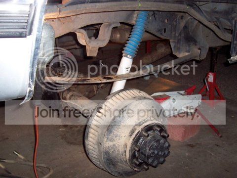

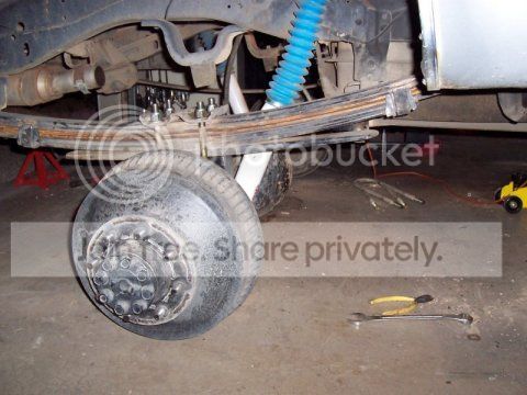

Took my spring packs apart and added two of the longer leaves from a separate pack, raised it pretty level and firmed up the ride back there quite a bit. Not harsh, still bounces over bumps, not like a dump truck, but obviously not like a Caddy either.
Dumb question maybe. what do you do about the clamp that holds the pack together. My spare set of 52's looks like I can remove it but on the Burb pack it doesnt.
I cut the tab off that wraps around the top leaf, leaving the upright portions, I was wheelin it quite a bit while I lived in Arizona, rocks and such so I left them the way they are to help fan out more for more drop. It hasn't caused any problems at all like that either, with any sort of driving or towing. I don't believe I have even messed with the springs since I did that about 6-7 years ago now.
