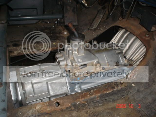

Is this a 4500?
Comparison pic...this is a NV4500
Rene
Yeah, but so did some later SM465's...
I also do not see the output extention housing in that guys pic. That's where 5th gear lives. You can see it in my pic, the aluminum housing part at the rear of the tranny.
Rene
The 93-95 Nv4500 has the Bottle neck shifter but looks the same as the 96 and up which will have the 4 bolt square top shifter.
I think it's a 465 from a late 80s 2500. I asked him what year, and then how many lugs, but when he said from an 89-90, knew already that it was a 465. Sucks cause he wanted $250 for it, probly get for $200 maybe less.
I looked there too, can't tell by the pics either, but the length of the shifter snout leads me to believe its a sm465.
Guys says it's a 4 speed with OD from a mid 90s Chevy.....
Rene

Here is a shot of my NV4500 during assembly. It shows the damper and the 5th gear assembly quite nicely. In order for this to work on a SM 465 the whole shifter assembly would need a re-design, plus a custom main and countershaft, plus, etc etc...
Rene
