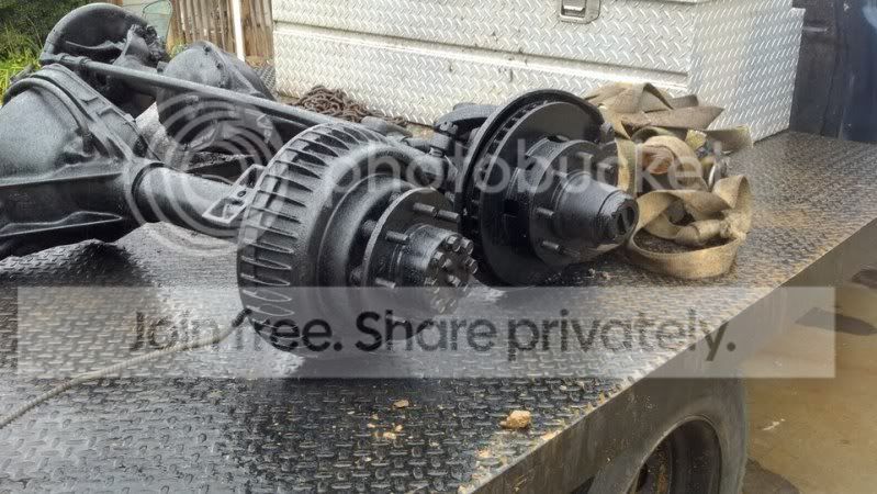

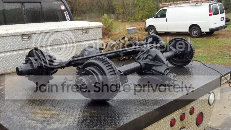

I found a local guy who has a set of axles for sale. 14-bolt ff, open carrier with 4.10 gears, front Dana 44, open with 4.10s.
$400
My rear axle is about toast. My buddy was going to give me a 14bsf, but I'd have to regear my front to match or regear both depensing on the ratio it has, plus swap out my outers for 8-lug.
With this one I can sell my front axle and maybe part out my rear axle and recoup some money, and already be geared 4.10. I just don't know about the open diffy though. Of course, it won't see anything more than the beach for the the forseeable future, but I still like to know I have that extra grip if need be.
Should I jump on it or pass? The axles are complete with stock leafs and all.

I don't know if he did this but it looks like he either spray painted them or he actually did go thru them and clean them up and probably fixed anything wrong, if that is the case, I say not a bad deal.
And yes this is not a flat top knuckle.
They are spray painted, he said he didn't go through them, just pulled them out of a junk truck.
