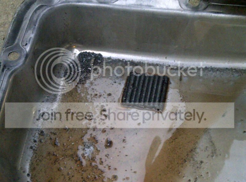

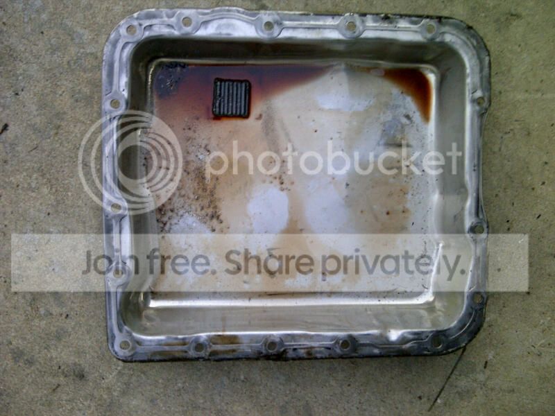

Went wheelin today. I got stuck side ways between two ruts. When i went to reverse out i just heard a loud grinding sound, same thing when i tried to go foward. Shifts into park, rev, neu, over D, 3, 2, and 1, it just does not go anywhere and makes a grinding noise. So i got home and pulled the pan, and this is what i found. Is it bad? What does it look like to you?
eww, looks like metal sitting in the bottom of a pan that should only be holding fluid. Doesn't look good but I'm no trans dood.
Yeah, im not either but i think its toast.
I'm not a transmission guy, but I'd say that looks like a tiny amount of wear which is probably normal. Now that big square thing ... no idea, but that doesn't look good.
You gotta remember, those gears are pretty big in an automatic transmission. I'd say you more likely broke a shifter mechanism or something small, not something big.
But again, what do I know? When my old Blazer had transmission problems I just sold it! :whistle:
time for a bowtie overdrives or monstor trans or a guy you realy trust local .
and i would not reuse that case . to much trash threw it if you ask me.
and do not forget to flush the heck out of the cooler lines and cooler to keep any trash from getting in to the fresh one you will be installing.

He confirmed my trans was shot.
