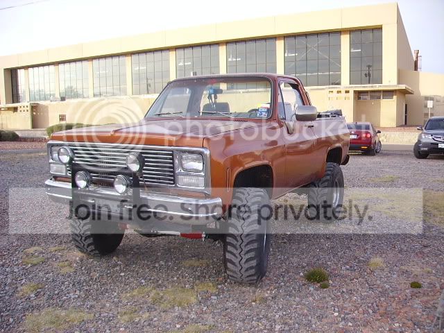

This chevy is getting parted out at a local junkyard (FYI- Yuma AZ). Does this "bumper guard" really provide any protection value when offroading? If there's any value in strapping it on my stock 88 k5 bumper I'll see how cheap I can get it for. Looking for feedback.

I've got one of those.... they are nice, and they bolt fairly solidly to both the frame and the front bumper. they will only protect the center of the truck though. if you want to keep the stock bumper, they are about the best protection you can get.
mine has light tabs and tow hooks though.
Those come in several varieties ranging from cheap chromed dress up ones with thin tubing and 1/8" sides,to ones made by Smittybuilt and other good name brands that were very rugged...
I had one of unknown origin on my 75 K5 (it was 2WD!) and it was a rugged one,the tubes were thick as schedule 40 pipe and it had 3/8 flat stock for the sides..it weighed enough to sag the front end down a good inch when I installed it..it had light tabs and hooks on the sides too...
The crome guard in the photo looks cheap. One way to tell is if the tubes are not welded. If just bolted then cheap. Also some mount to the frame.
