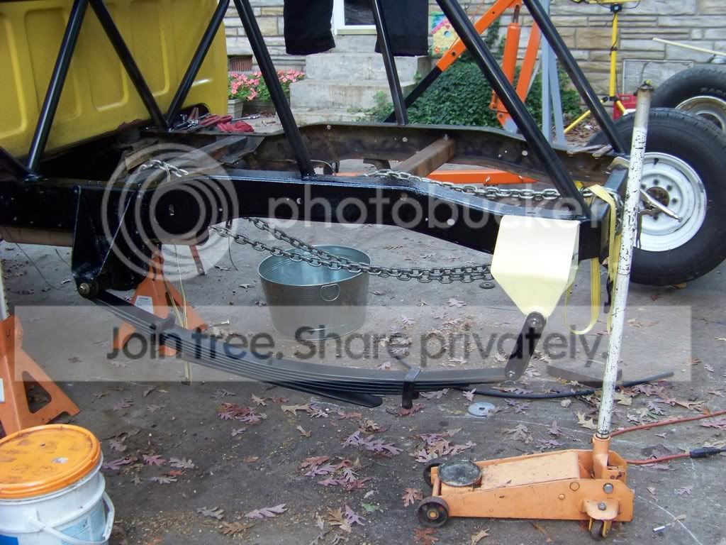

now i know how i can do this but i need to move my flip way up the frame to get the first shackle flat but am i gonna be able o move the flip up on an angle like that without messing anything else up??all i can see is im gonna loose some lift..anyone

it can be made for the flipped kert and i have talked about it many,many times..it can be done easily but on my frame the flip would have to go way up the frame unless i was running 64s..mabye 56s but im running 52s...dont ask why not do this or this im just wondering if i can move the flip that far up the frame with no problems

It looks like the flip would move up 1-2" if you moved it forward, that would lower the truck by .5-1".
that is to get the 1st shackle horisontial??here is what im thinking of doing
1st shackle being the d1y 7 inch shackle,2nd being the diy udsr shackle..gotta make the bump stop for compression and i might need to do something like a strap for droop right??
