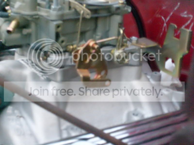

Alright, I got the bracket to install the cables. Now my question is, is this the right one on the Q Jet?
It looks correct, put the cable on and adjust it, that's the only way to tell, if you get full throttle and the cable is pulled all the way out, your good.
