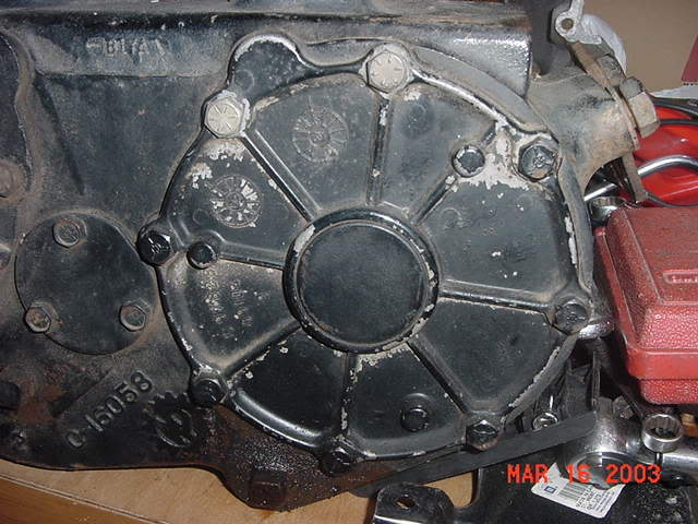

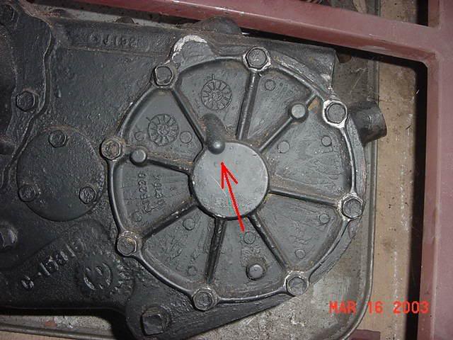

This is what you're looking for -
With oiling vein = syncro version
full
No oiling vein
full
