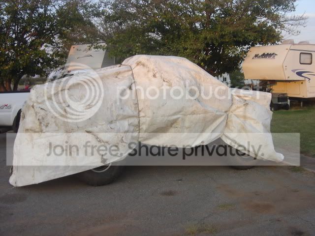

The Beast Wrapped and waiting his turn in the shop..

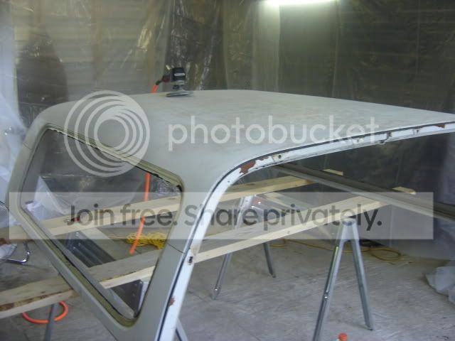

Windows Pulled and sanded...
Taped and ready for first coat of primer...

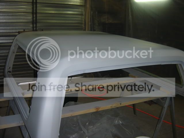

First coat of Primer sprayed with HVLP Sprayer, have not used this type before still figuring it out...hehe

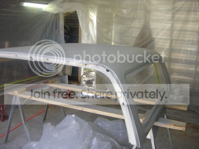

Wet Sanding after first coat of Primer...
Second Coat a lil thicker in content, starting to figure out HVLP sprayer...

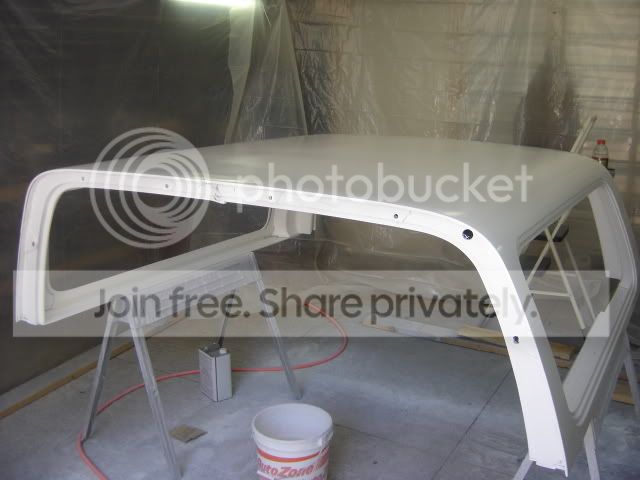

Painted and wet sanded second coat

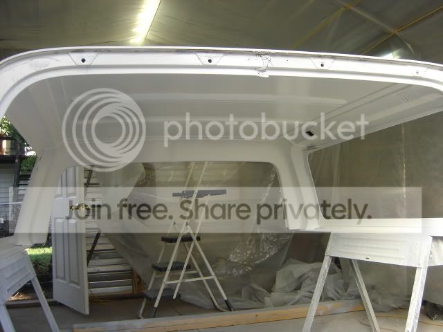

Even sprayed the inside, Looks like a new Top...
Alright, You cant see it in the following pics, but I got wrinkled paint bad after I sprayed the Clearcoat. I tried something different on last coat. I did not mix the CatII Catalyst in the last batch of paint seeing how the paint did not call for it. But the first two coats I mixed some in for the heck of it. Well since I did not mix it in I think that is why I am getting the wrinkles.. Grrr
Looks good at a distance, up close looks like crap..
The only thing I can think of is to sand down to the second coat of paint and then re-wet sand with fine grit and try to respray clearcoat...

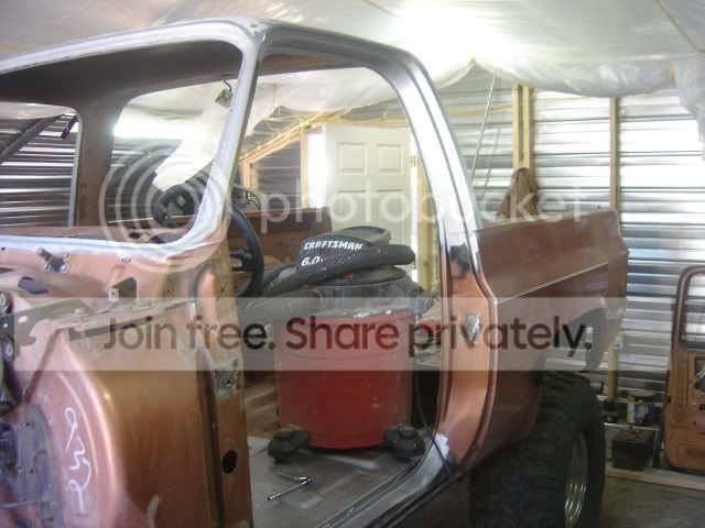

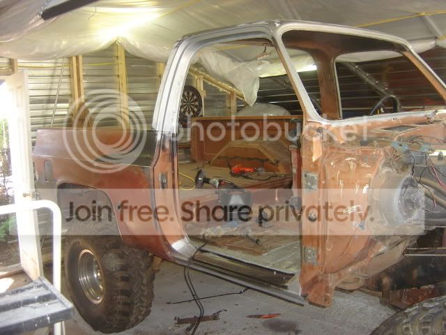

The Beast is in the shop and stripped...
Well the body work has begun and so far so good.

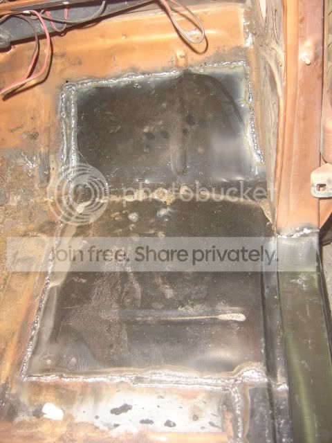

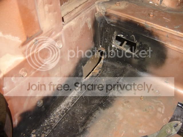

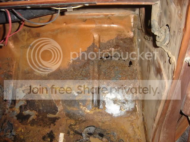

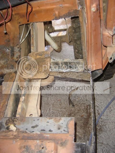

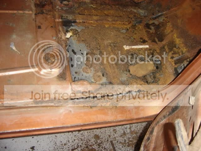

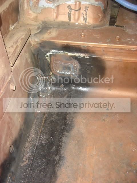

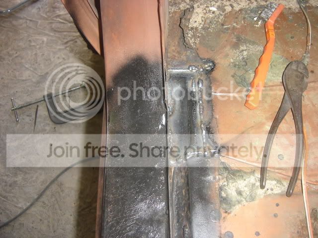

Passenger side floor board rusted..

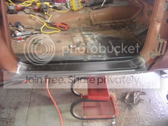

Rust Cut out and gone...
Patch work Initiated. No picking on the welding job. Besides its gonna be hidden by either sound proofing and carpet or ground down and rust bulleted and body filled... LOL!
Had to patch drivers side also..
Now for the grinding, Rust Bullet and body filler. Then what I have been waiting for the Primer and paint... YEAH!!!!

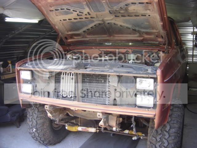

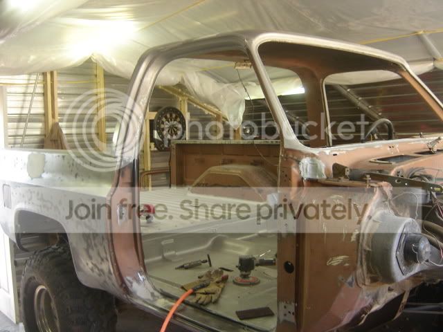

"The Beast" undergoes transformation. Front clip removed

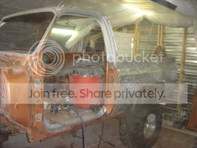

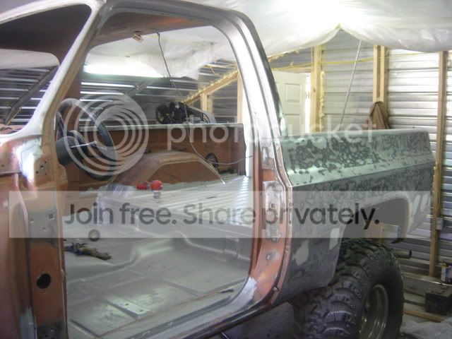

Sides before sanding begins..

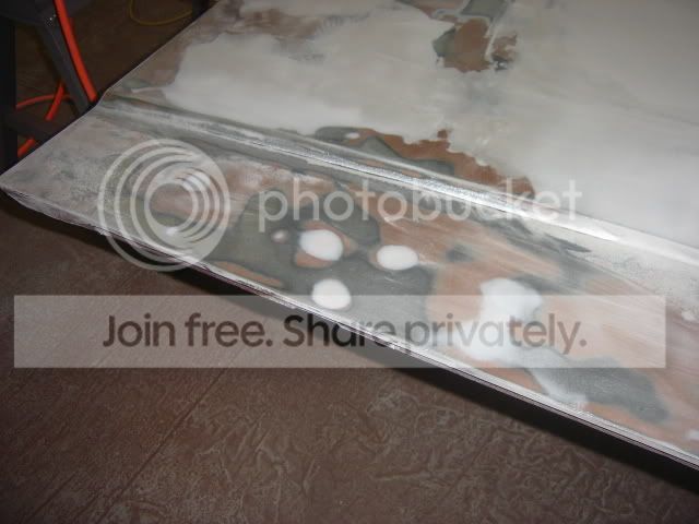

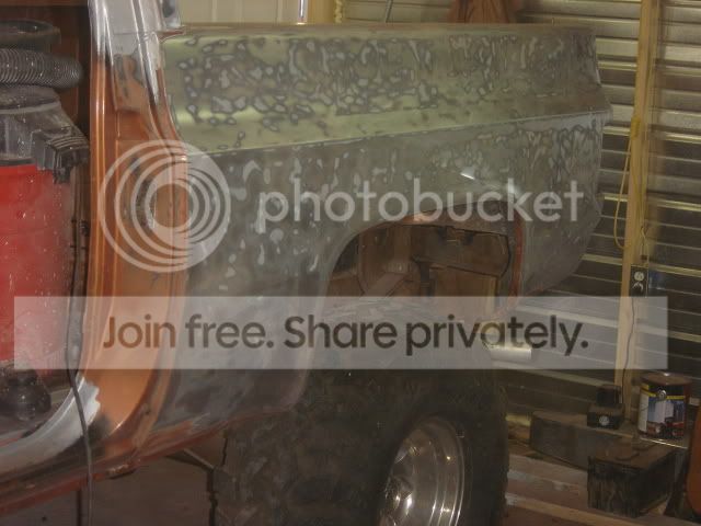

Side after sanding, had to go a lil deeper then thought due to old clear and paint cracking deep...
Close up..
Bodyfiller in place and sanded...

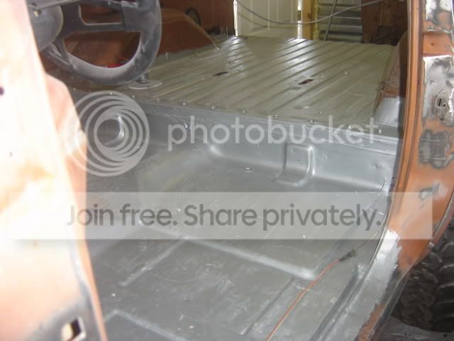

Entire floor rust bulleted..

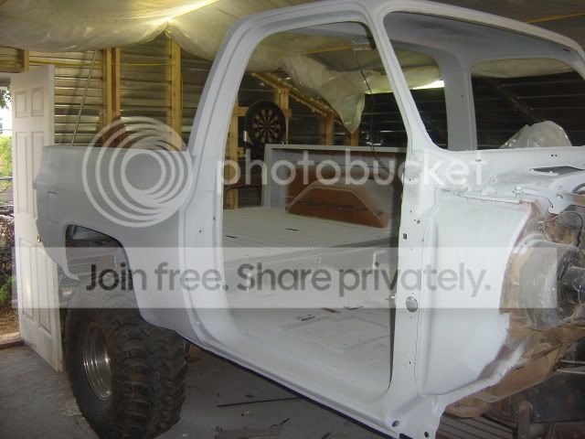

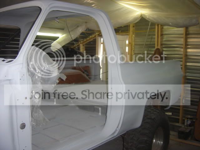

Truck primed...

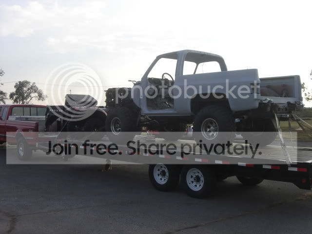

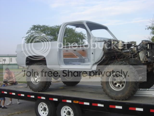

Truck on trailer, had to move it out of garage so I could work on fenders and hood. Not enough room for both.. Grrrr
Yes that is a ford pulling my beloved truck around.. But I will get him back after project is done.. Hehe
Truck rewraped and waiting to go back into shop...

Holy shiite!!! NICE WORK MAN!!! You commented on your welds, was that your first welding job? I've not welded yet, but need to start.
:bow::bow::bow:
Well I bought a welder and messed around with it for a lil bit and dove into this project with it.. I am still learning..:crazy: Thanks for the :bow:
Did you spray the Rust Bullet? I'd like to know if you thinned it and with what. How'd you set up your gun? I'm a complete Noob on painting and any tips would be appreciated!
Rust Bullet
No I did not spray the Rust Bullet. I used a brush and spent a couple hours doing the floor. That is only one coat so far.. I have another quart to do the second coat with and I will use the rest of the quart since it goes pretty far to do the under body part of the floors and such.. I might try to spray that but I am affraid to use a gun.. I dont want to mess up the gun by using that stuff through it.. :haha:
Color Combo
Yeah, I hope they look as good together on the truck as they do in my mind...:rolleyes: But wait till you see how I got them planned to be sprayed.. ie. graphically.. :p:
How much rust bullet did you end up using? I`m wondering how much to get to paint the underside of my new cab with...
Rust Bullet
Funny story <short Version> Well as I was looking online found an advertisement for the auto six shooter.. Looked like it was six pints... I never read the description.. :doah: Well turned out to be six 1/4 pints.. That is what I used to do the interior of my truck. I ordered another quart to do the second coat and the rest I will use on the underbody. I am gonna buy a cheapo paint gun and spray the underside... Should have plenty.. We will see:crazy:

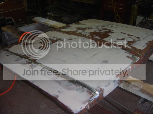

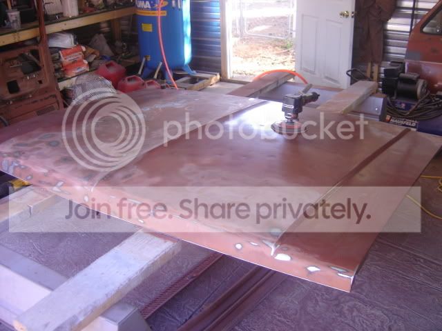

Sanded the hood..
All I can say is Hail damage...
started sanding down hail damage repair..
I will get photos of the fenders before I body fill to show you what they look like.
