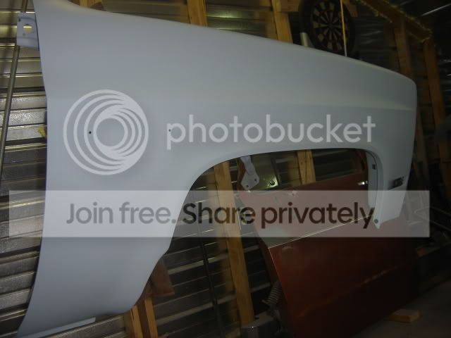

Fenders Update

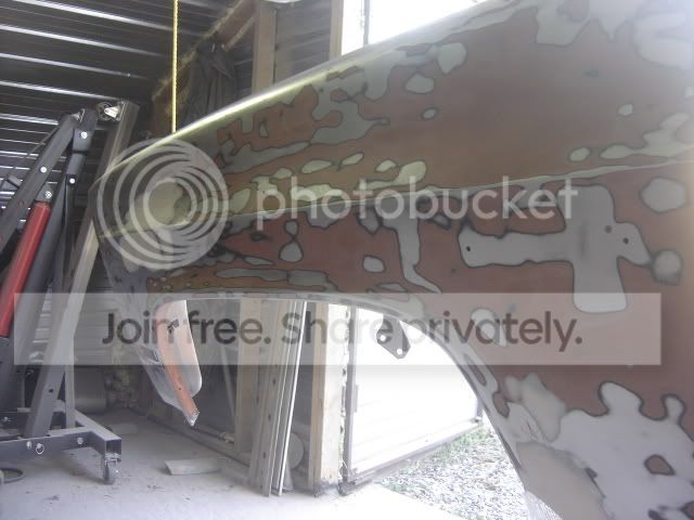

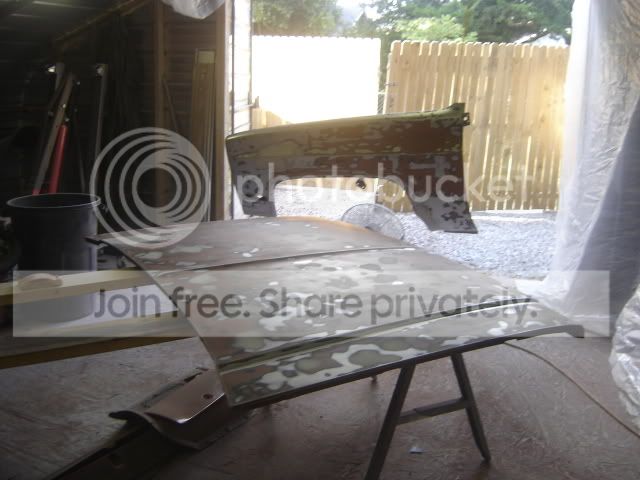

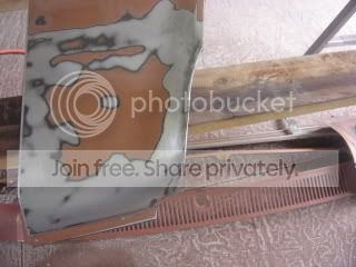

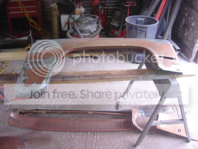

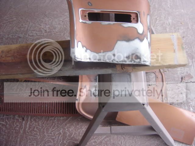

Well Been working on the fenders like I said before.. Here some photos
Fender, Trimed, Welded, Ground, and Sanded..
Rear Of Fender close up..
Front of fender close up..
Now both again filled and sanded. I need to do some fine tuning but they are coming around..
Try to get them and the hood completed tomarrow so I can start working on the doors.. More to come..
Welder
chevy wrangler said:
thats some awesome work Izzy!!
what type of welder did you use??
Hobart Mig Welder.. Not sure the size. A small one with Argon Gas.. Does good job for a Novice at welding...:wink1:

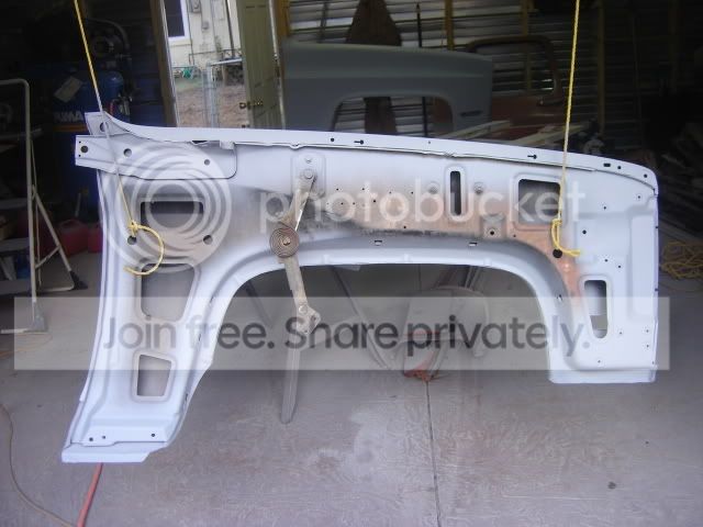

Front clip Primed...

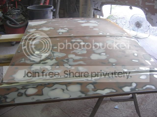

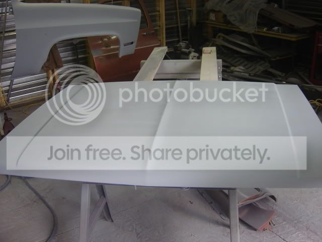

Alright so here is where I am so far..
Hood after alot of work fixing a dent driverside corner closest to windshield.
Front clip body filled sanded and hung in shop..

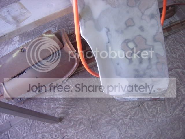

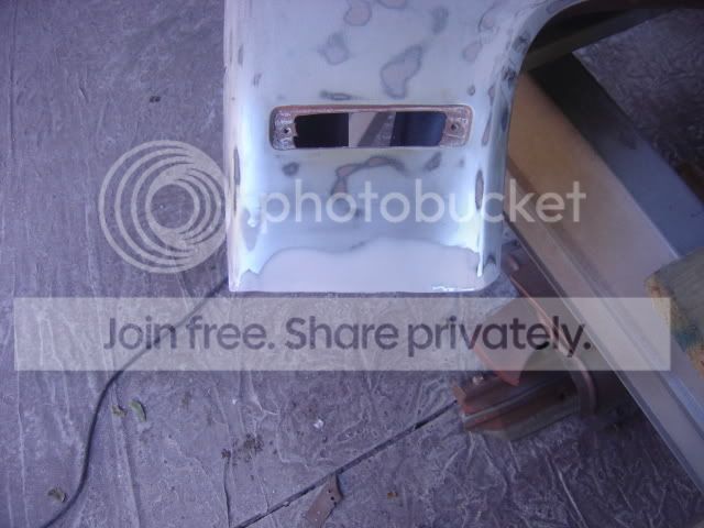

Front clip primed... looks somewhat decent other then a missed hail spot on top ridge drivers side fender.
close up of bodywork on front of fender.. not to shabby..

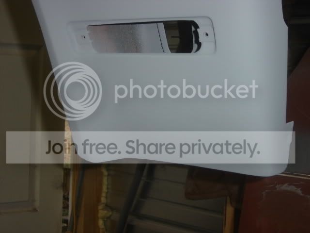

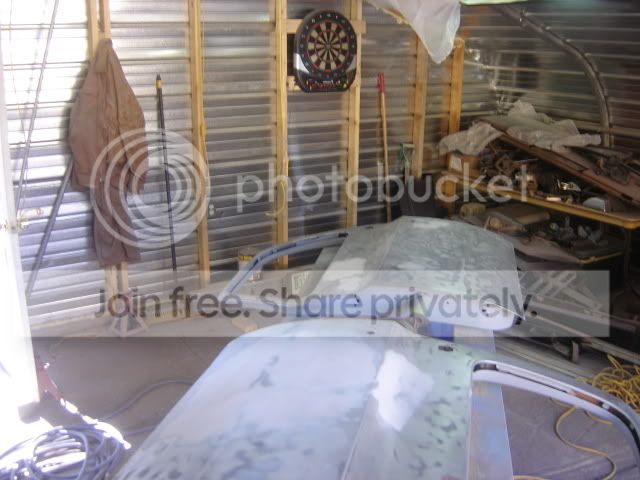

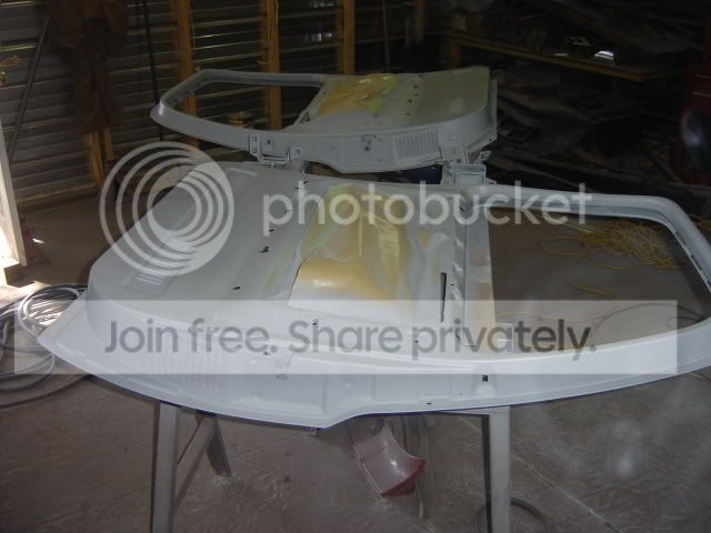

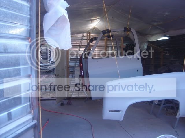

Doors primed and doing jams...
Well I have been kinda busy with this project. I took off this week from work so I could be painting the truck this coming weekend.. Here is what I have done.
Doors had to be sanded down and body filled. I found a nice surprise on the passenger side. PO must have leaned it up against a tree or pole..
Doors primed..

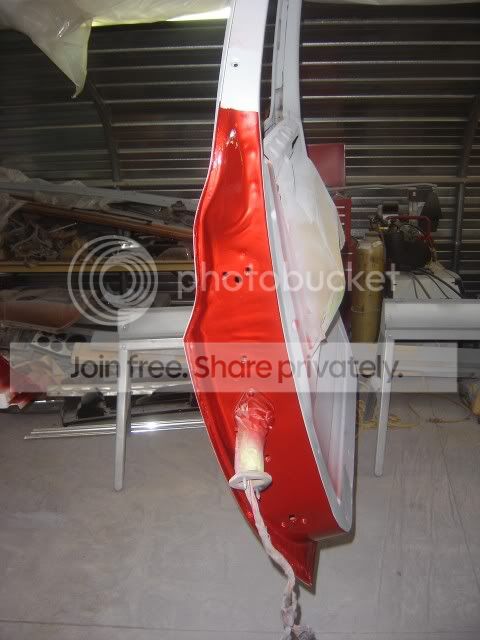

The shop turned into a K5 meat locker so I could paint jams...
Door jams painted, turned out nice.

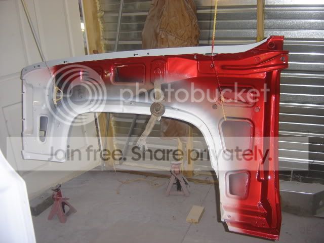

Front fenders inside painted.. Wonder what Izzy has in mind for the paint scheme.. :rolleyes:

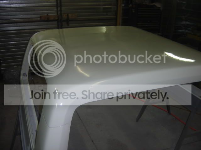

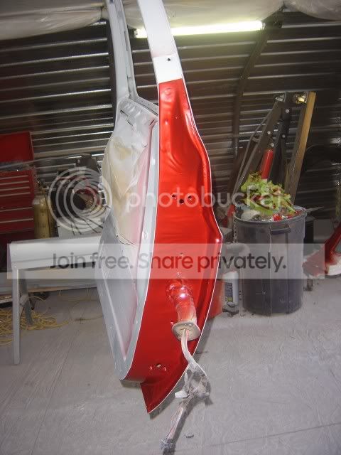

The Painting has begun on the truck...
Well I am waiting for paint to set up.. then I am clear coating the engine compartment and the front of the door jams along with the dash.. More to follow..:p:
