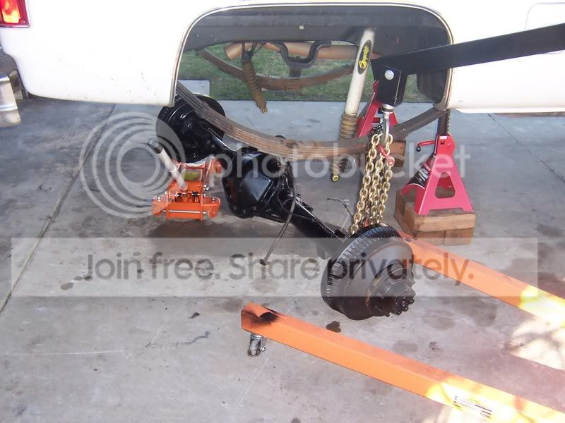

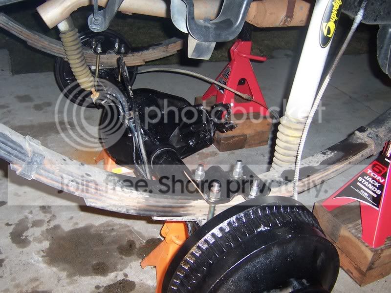

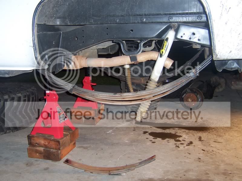

    I just got some lumber from a big truss manufacturing plant/lumber supply place across the street from where I work...they worked out great...
