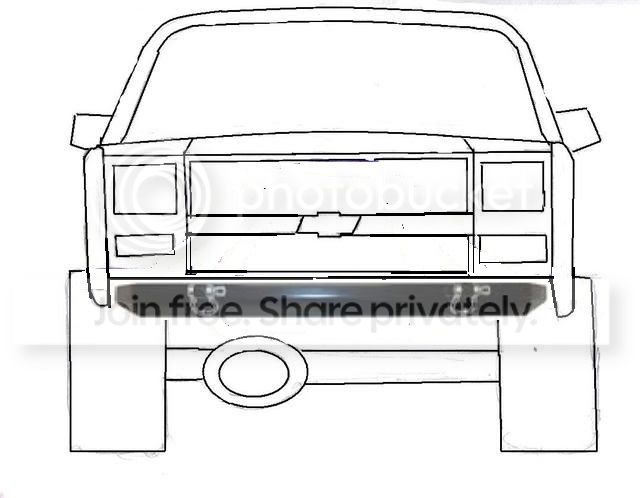

speaking of jeep parts, i seen a rock bumper for $89 bucks. No way your going to get a blazer bumper for that price...
I know it would be shorter, but for $89 bucks...
here is the bumper:
images.ashx
and here is how i was thinking it was going to fit...
and then with a little trimming...
IDK.. just an idea...
I would bet that bumper is at least 10" too short. Jeeps are way narrower than a full size
You could buy a narrow Jeep bumper and rework it, but you would have to section it to make it wider, make the center part taller to fit over your frame rails, remake or rework the mounting brackets and now you have about as much work in as a bumper from scratch. Plus it will be all hacked together looking, still not hold a winch, still have to be painted and probably be no stronger than a stock bumper. So why not run a stock bumper? Come to think of it, $89 is pretty close to what I spent on steel to build one from scratch.
