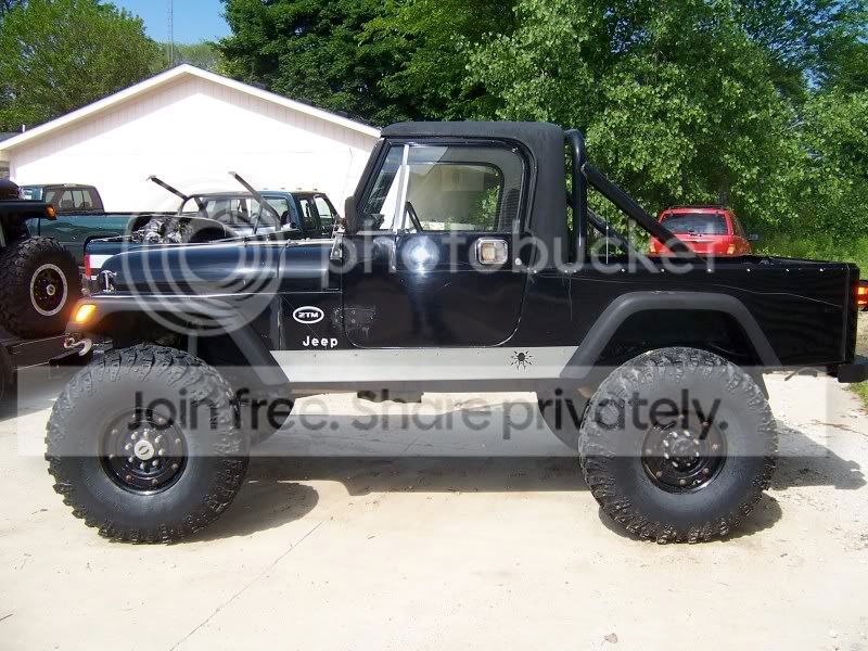

I would go with a early cj-8 (scrambler) for the added wheelbase. Throw on some longer springs, xj or waggoner's are pretty popular. Then throw some 3/4 tons, there are plenty of full width swap kits out there. Then to tuck the tires back in run some h1's or h2's
