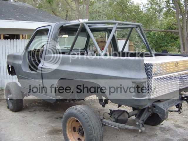

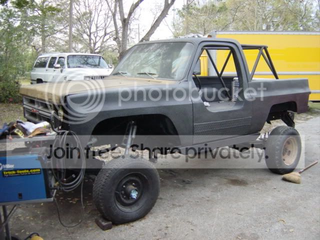

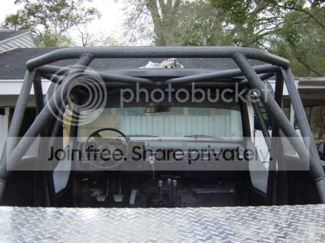

    As usual my Jimmy project is behind schedule,but I WILL have it ready for ECBB.
    This weekend I started the cage,I got the back done but still need to finish the front half.
    I painted the body with Zolatone paint.This stuff is is great ,it's a real durable textured paint.
    I'm getting my 6.2 heads back from the machine shop this week and should have the engine in this weekend.
    My Stazworks beadlocks will be here on Thursday and I can finially mount my 39.5 IROCKS.

    Those doors are freakin sweet dude.

    Dude that thing looks SWEET!! :)
    I really like your cage but is there a interior cage??
    Is that bedliner on everything???

    Thanks I have alot of time in those doors.
    I still need to complete the front half of the cage.I built and painted the rear half on my drive way then bolted it in.
    The paint is Zolatone,Its simmilar to spray on bedliner except its not as rough.
    It's hard to see in the pictures but the body is back and grey fleck color.
    I'm going to paint the floor boards and aluminum storage box with a black on black fleck color.

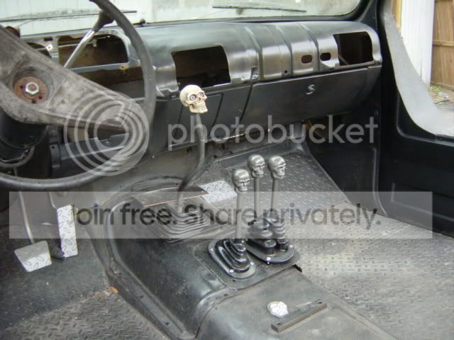

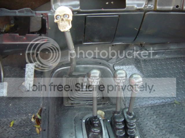

    I want those skull shifters. I'd do a manual swap just to have it in my truck.

    The door's look great,but those shifter skulls are bad ass.. Where did you get them?
  13. 82dieselburb
    82dieselburb 1/2 ton status
    Joined:
    Jan 6, 2004
    Posts:
    105
    Likes Received:
    Location:
    central Florida
    I got the skulls on the triple shifter from JC Whitney.They were chrome with red eyes and I painted them .I don't want anything chrome on my truck.
    The trans shifter I got on ebay.It's real detailed,has cracks in skull and eyeballs.
    Here is a closer pic
    [​IMG]
    I'm kinda going with a skull theme on my truck.

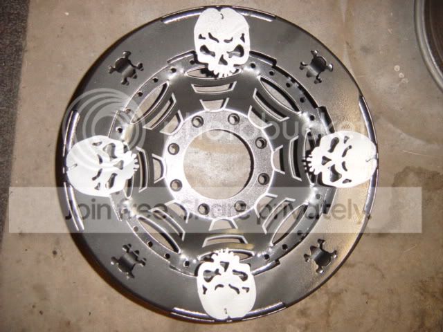

    Here is a CAD drawing of my 17 inch double lock wheels from Stazworks with a skull rock ring
    [​IMG]

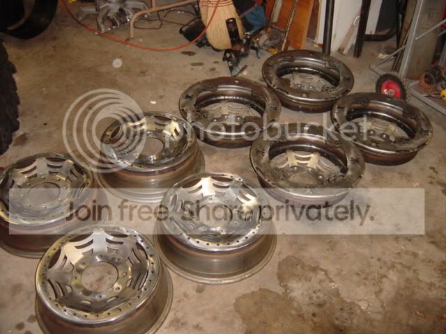

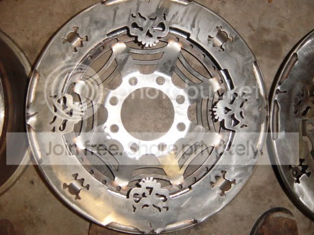

    I finially got my beadlocks,they were about a month last but well worth the wait.I painted them with rust-oleum hammered paint.I figured I'm going to scratch the s**t out of them anyways and they will be easy to touch up .
    I may have time to mount them tommorrow,if not I'll have to wait till Monday because I'm going to Nashville this weekend.When I get back I need to go balls to the wall to get my truck done for ECCB.I probally won't have much time to test it ,so it looks like Tellico will be my testing run.
    [​IMG]
    Here is some pics unpainted
    [​IMG]
    [​IMG]

    Here's the final pic.....
    [​IMG]
