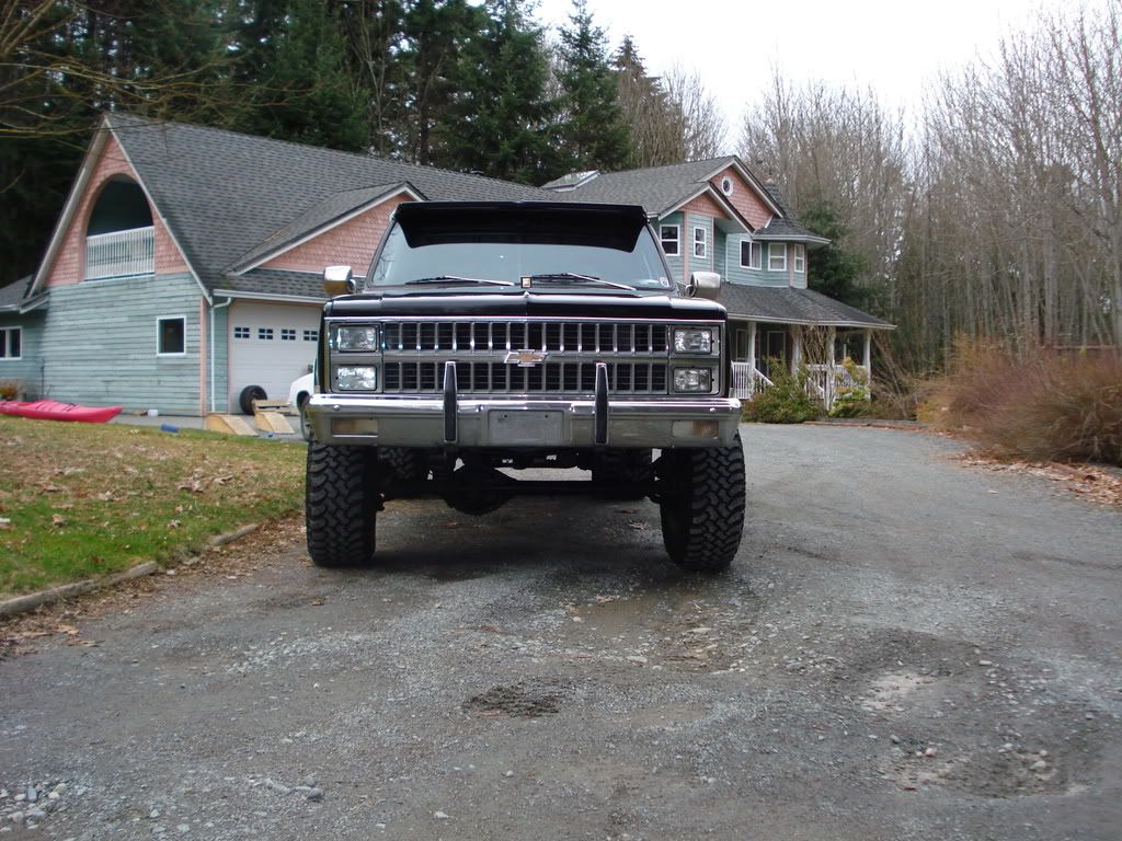

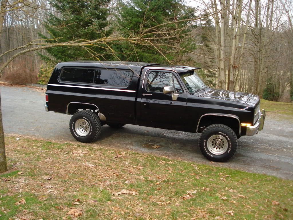

Just got a 81 3/4 ton 4x4 Silverado Camper Special
gm guy
May 1, 2004
151
Vancouver Island but work in Ft Mcmurray Alberta C
My new toy, finally! I had a rust K5 a few years ago but it rusted away...
I found this 81 3/4 ton 4x4 Silverado Camper Special that I'm really happy with but need to swap in a fresh 350. The truck sits too tall for me to use my normal cherry picker, but I do have a big swing set style setup but even that will be a tough pull unless I remove the front grill ect...
How are you all swapping engines in these big trucks? And yes I've done a half dozen 350 swaps in GM vehicles just not a lifted truck...
Advice, tips, bring em on!!!:bow:
