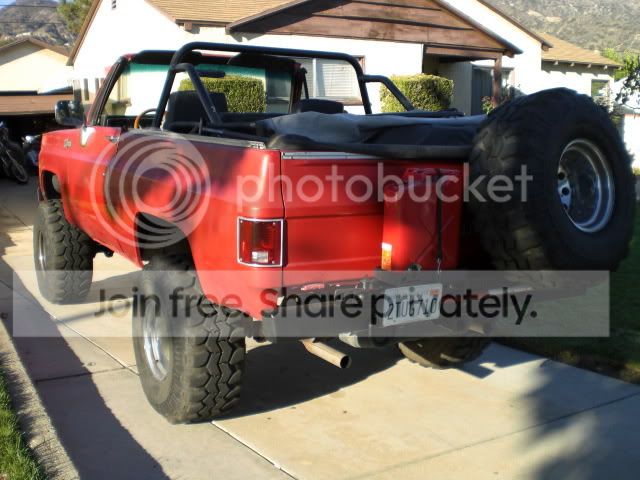

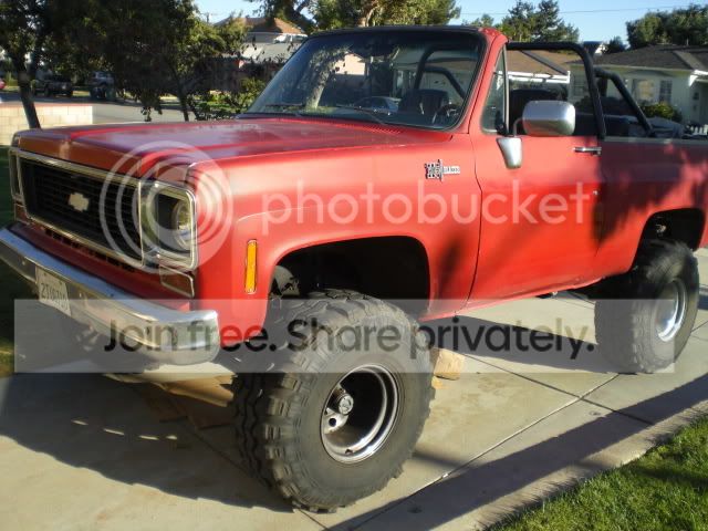

'73 K5 Blazer convertible (no factory hardtop). Its got 36 in. Swampers, 3" Body lift and what looks like around 2" lift blocks on the rear springs.. so i'll assume 2" or 2.5" front springs.

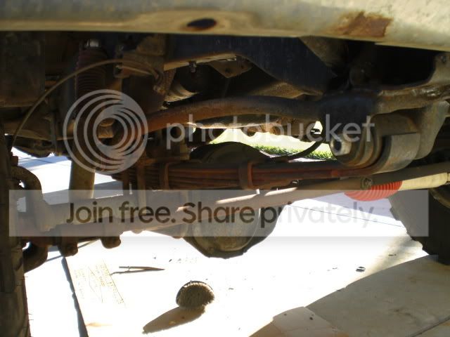

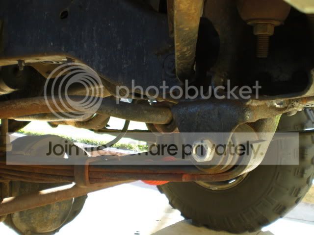

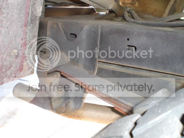

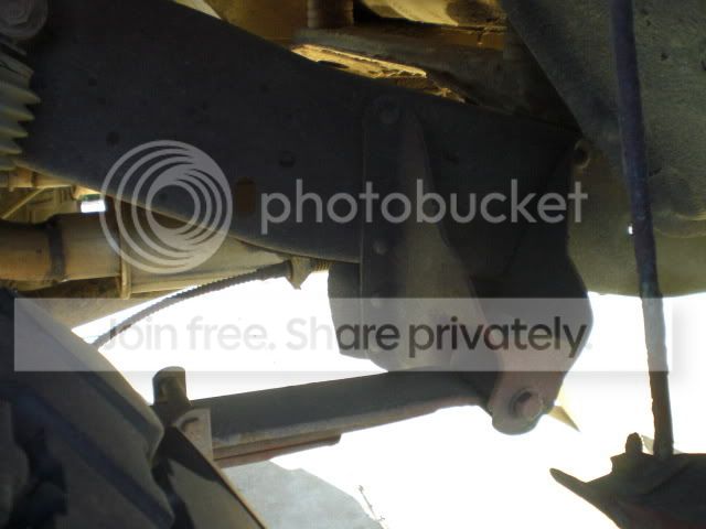

here's some shots of the front suspension

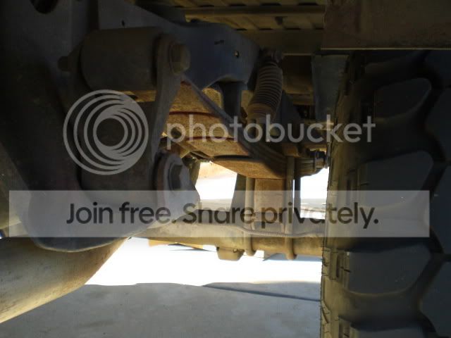

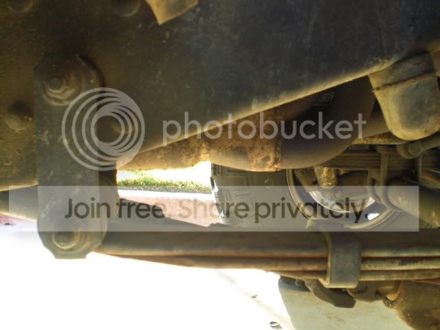

here's the rear
The fronts and rears look pretty stock except for the rear lift blocks and maybe the front springs.. correct?

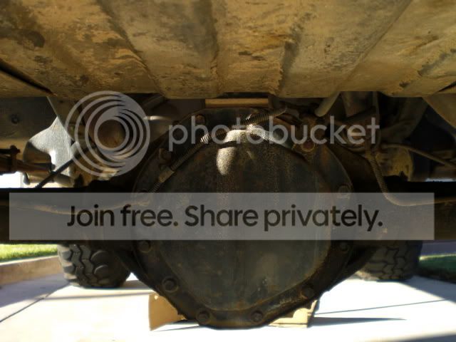

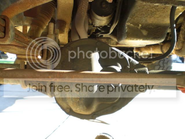

axles
looks like a dana 44 front and a 12 bolt rear right?

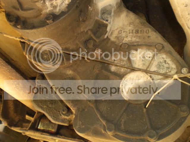

transfercase
NP 203?? Couldn't find any more markings... might hafta clean off all the caked on mud before I find the right markings.

Well you got pretty much everything figured out, and yes it's a 203.
Now for the body lift, if done right it's not a bad thing if not exceeding a 2", but a 1" is good enough to clear the body off the drivetrain so you can work on it eaier if nothing else.
The reason people here like the shackle flip more than the lifted springs is because lifted springs by nature will be stiffer because of the arch, the front will handle it better because it has some weight on it and most ditch the sway bar which helps softening the front suspension.
For your purpose, I would either, which ever you feel more comfortable with.
And I wouldn't do much more to this truck for the same reasons, except maybe good maintenance.:D
I recomend going with a 4" tuff country Ez-ride all spring lift. Thats what I have and my truck rides pretty nice. Also get a set of extended braided stainless steal brake lines. Also get a set of heavy duty shackles from ORD along with a steering box frame brace.
Also I highly recomend checking out LMC for almost any replacement part. check them out at http://www.lmctruck.com
EDIT: make sure you oil your hood hinges regularly because they get real stiff and you can bend the hood trying to shut it.
First of all, I'm jealous. :bow:
Second is mods: 1" body lift, ORD bolt on steering brace, diy4x shackle flip, 4" BDS front springs, remove swaybar, have the passanger side steering knuckle milled, purchase ORD cross over steering kit. Looks like the 203 already has a part time kit (you have hubs) I'd leave it until it gives you problems. The 12 bolt and Dana 44 should handle the 36" tires fairly well if you're nice to them, I'd leave those for now as well. :waytogo:
I've run my 12-bolt and 44 w/ alocker and a posi for years on 35" mudders. no problems. If you don't beat it to death, yours will be fine. Ditch your sway bar too. It may look beefy, but it really does'nt do very much,except limits your front axle to articulate fully. Beleve us on that. Oh, and welcome aboard!:D
Your bolts at the front of your front leaf springs are too short, if that nut comes loose, you are gonna be in for one wild ride! Very nice truck! It has gotta be nice to start out with a few things already done, Tires especially.

To those that mentioned the leaf spring bolt... Funny, never noticed it when I was snapping the pics but yeah, I saw that. I'll take care of it.

My part-time kit has been in and working great for over 30 years, so I would have to say no, they are reliable.
Well you got a membership here - that should always be the first mod. The second should be a good set of used shop manuals on ebay. Other than that sounds like a solid plan. Very nice truck BTW. Yours even moves under its own power - that is always a plus.
Nice truck!
I agree with all of the above and will add my testimonial: Part time converted 203 is very reliable for trail riding. 4" (whether it's all spring or shackle in the back) and a 1" or no body lift will be perfect.. .keep the CG low and clear the 36's without too much (if any) trimming.
ORD frame brace - If your frame isn't already cracked by the steering box, order this soon.

I'll order the frame brace very soon, thanks for that.
Funny, I absolutley love the tire carrier/gas tank holder/ high lift mount bumper. Its damn beefy and looks bad ass. But I was almost gonna pull it off to sell. I ride dirt bikes and I don't want to trailer it anymore so I really wanted a bike hitch carrier. I'm going wheelin'/riding this weekend and i'll try to put the bike in the bed. I'll have to remove the convertible top and brackets in order to fit the bike but I do have a bikini top. Heater don't work yet so i'll wear my long johns!
