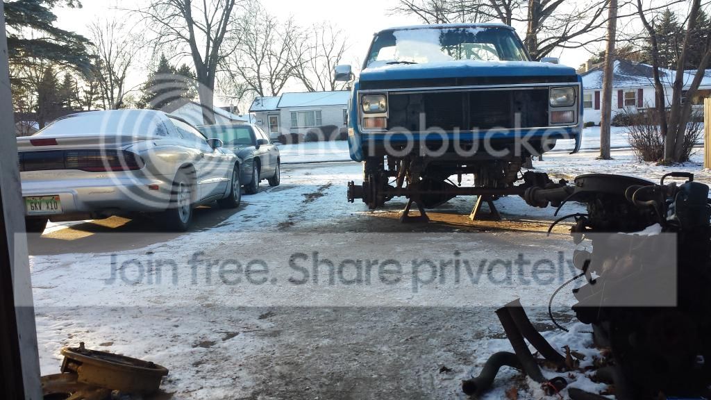

I was originally going to do this but i machined my DRW hubs to SRW. Mostly because i wanted 17's and hummer rims would run me $400.
http://s237.photobucket.com/user/nvrenuf_K5/media/K5 Project/DSC00193.jpg.html
