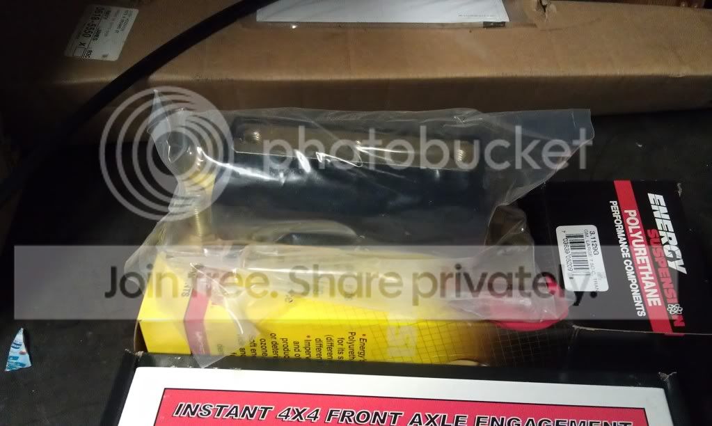

As far as more parts go I ordered a poly trans mount and the "competition poly" engine mounts from DIY4X...

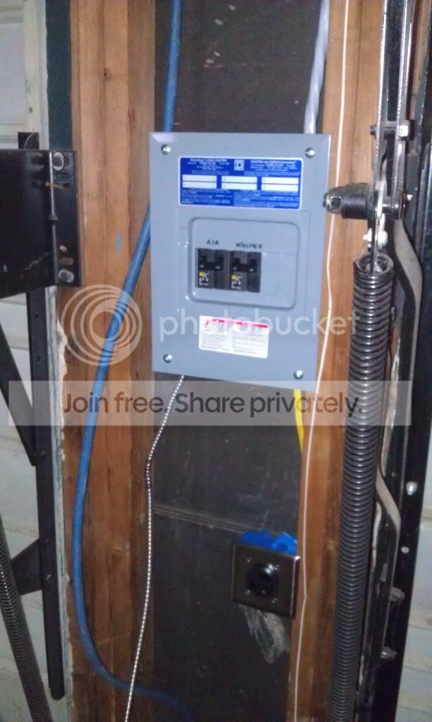

Well I'm finally able to get going on this. The garage is all setup and the electrician came today while I was at work and wired up a whole new 220 sub panel in the garage. It has a breaker and plug for the welder and a breaker with hardlines going to the compressor.

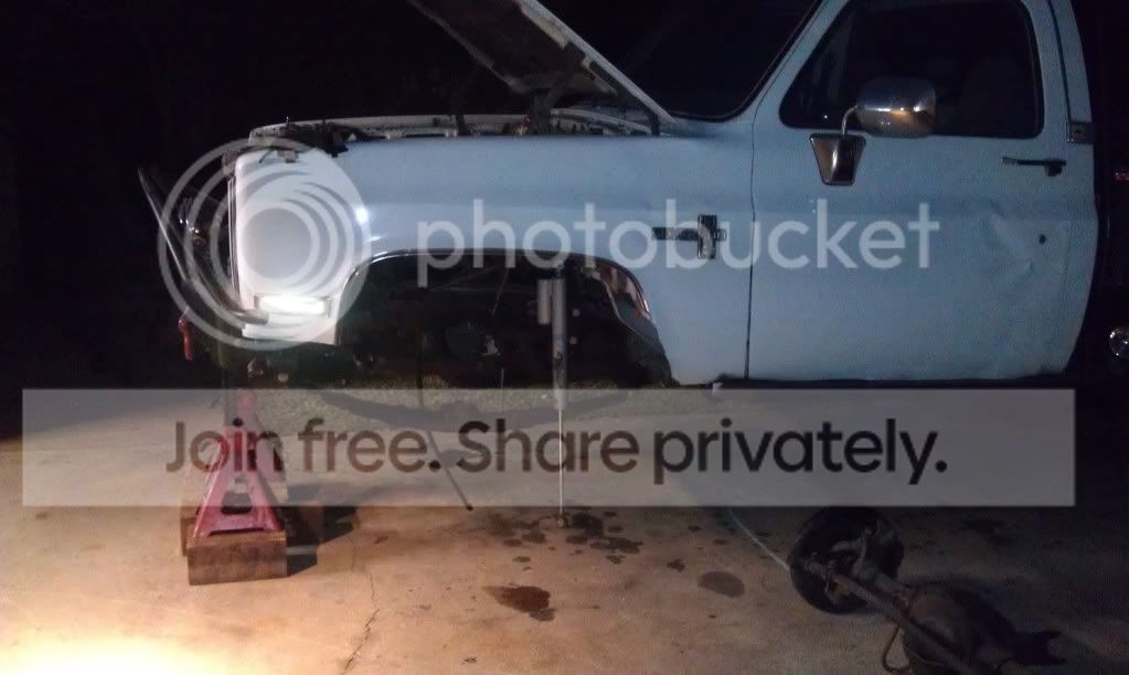

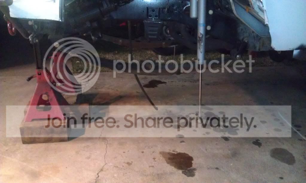

Started working tonight. Out with the old!

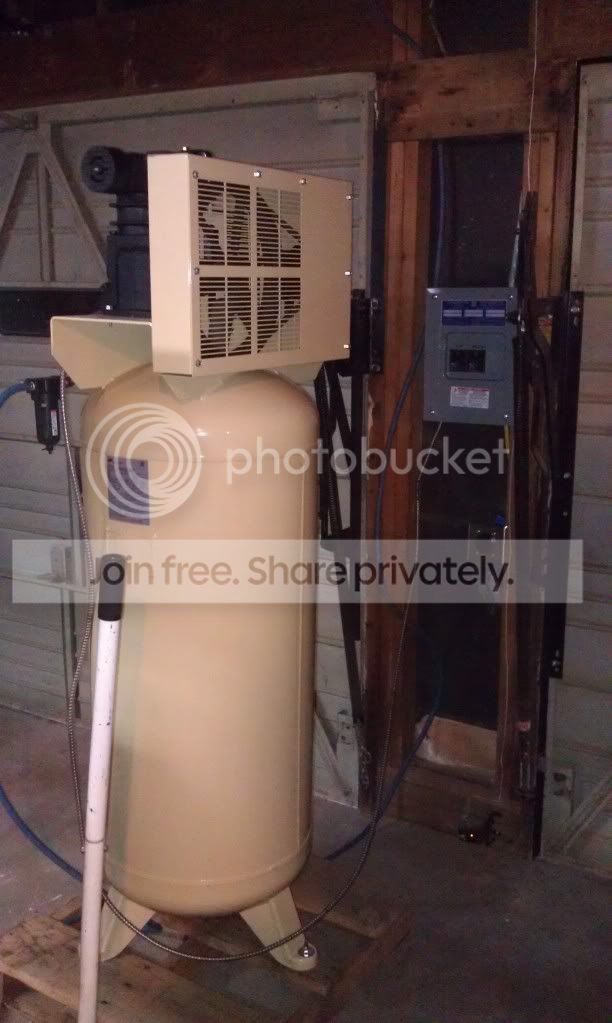

I freakin' love this new compressor. It hardly kicks on just using the impact and when it does it fills from 100 back up to 135psi really fast.

I believe I have the same IR. I can run the impact for a damn long time before it kicks on. Running die grinders, and having it keep up is really nice.

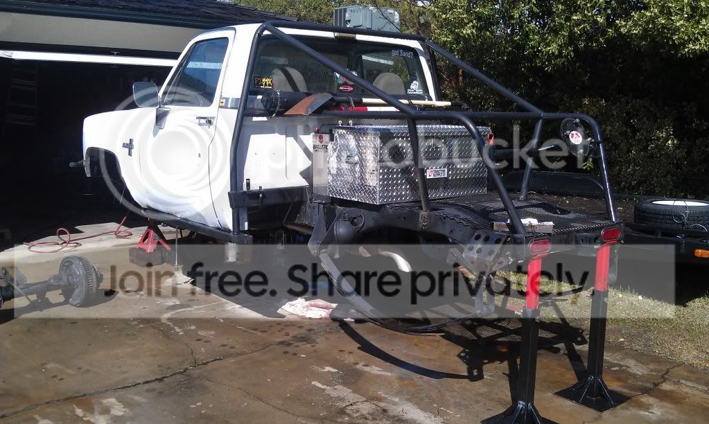

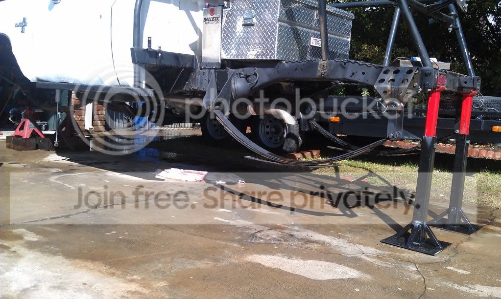

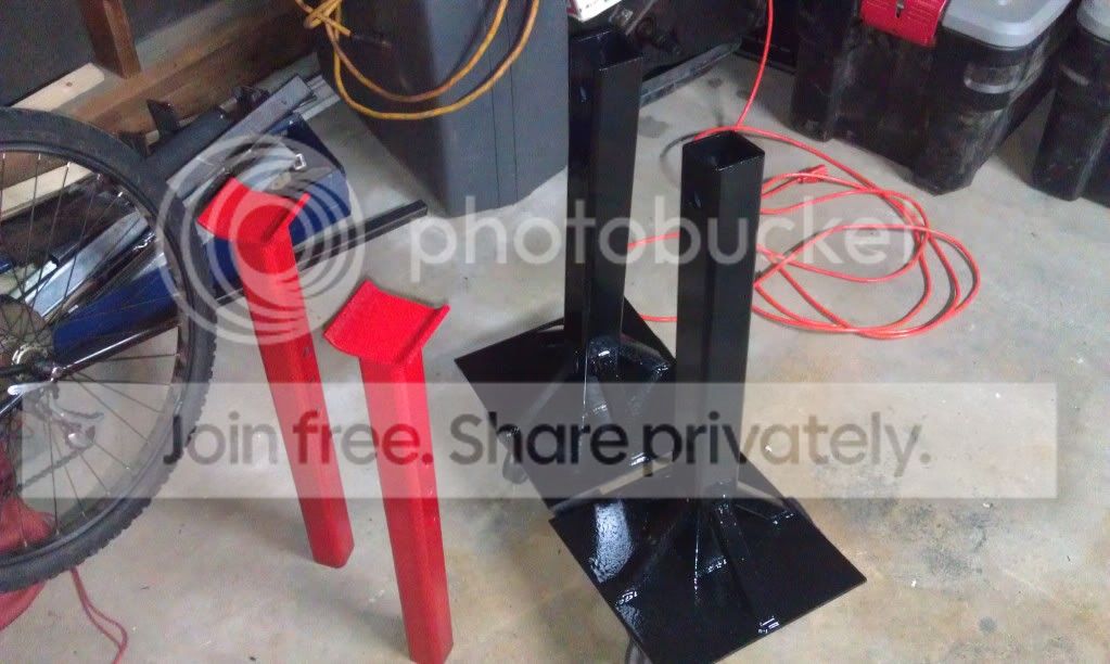

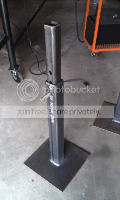

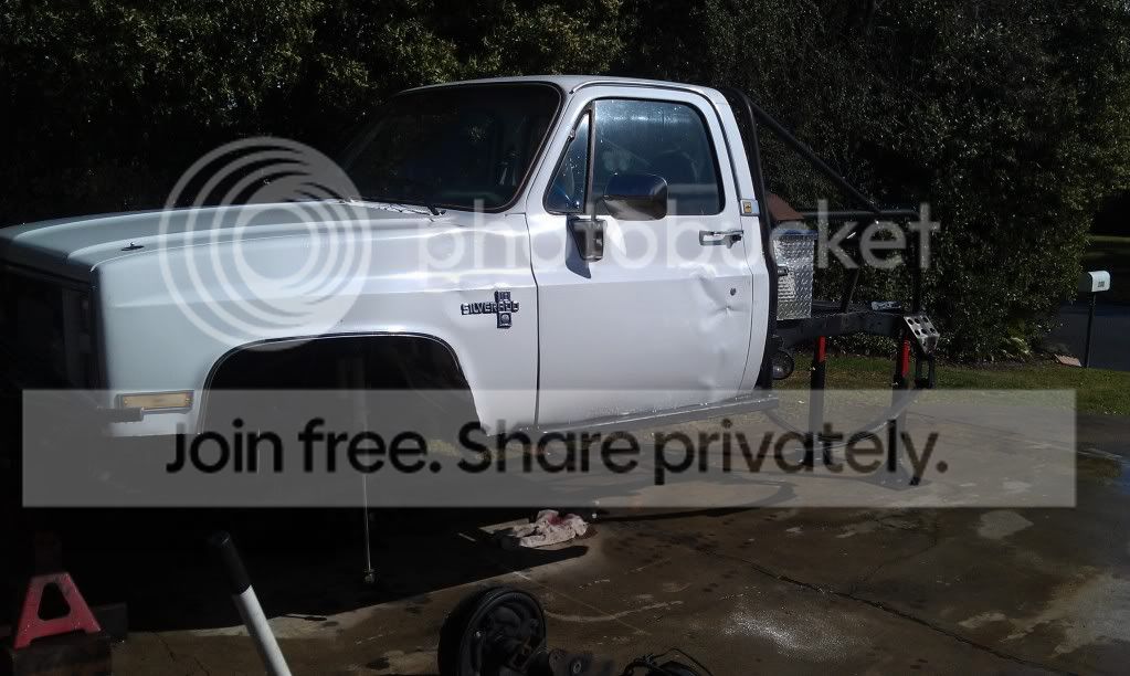

I ran to the steel yard and picked up some material this morning and whipped up some tall jack stands for the truck. It's going to be up in the air for a while and I only have 2 semi-tall jack stands that are tied up under the front of the truck.
It's 2.5" x 2.5" x .250" wall seamless tubing for the main upright and 2" x 2" x .250" wall tube slipped inside of it. Uses a 3/4" grade 8 bolt as a pin that's long enough so the weight is on the shank. The lower gussets are 1" x 1" x .120" and the base plate is .250" thick.
I tossed some paint on them tonight so when they're dry tomorrow (and hopefully it stops raining) I'll get them under the back bumper and work on getting the 14 bolt yanked out.
The main 2.5" tube is 24" tall for perspective.
Thanks, I figured if I was going to be under it I didn't want to skimp.
The material and bolts were about $150. But if I go buy another 24" section of the 2.5" I have enough of everything else to make two more stands. So I could have 4 of them for about $175 or so. Cheaper than most I was looking at online by a long shot.

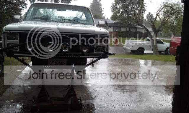

Started unbolting stuff out back and it started pouring rain on me. I tried to wait it out but eventually said forget it and just finished it in the rain.
Wouldn't ya' know it as soon as I drag the axle out from under the truck the clouds rolled out and the sun came out.*

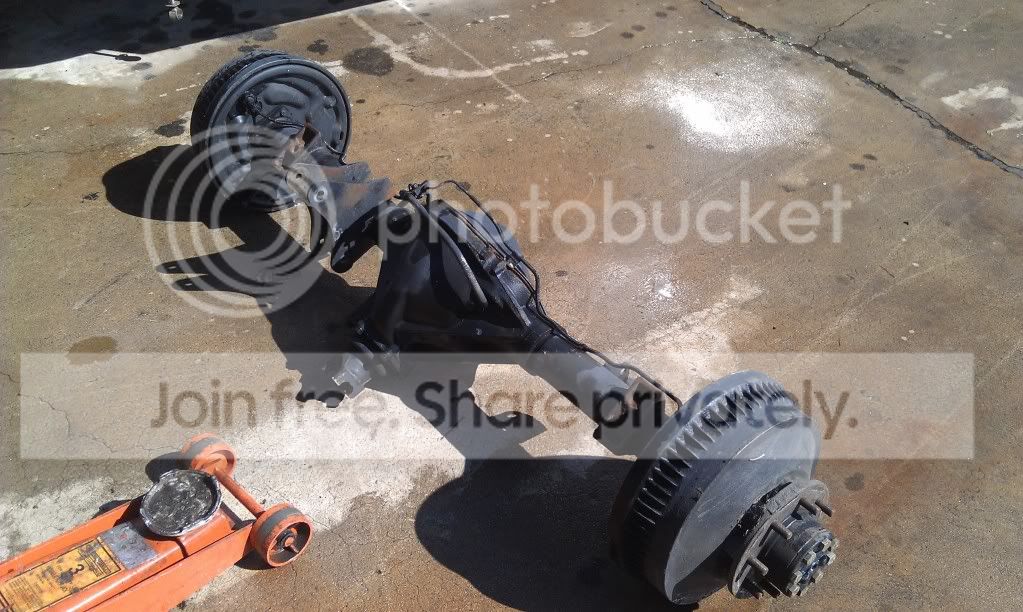

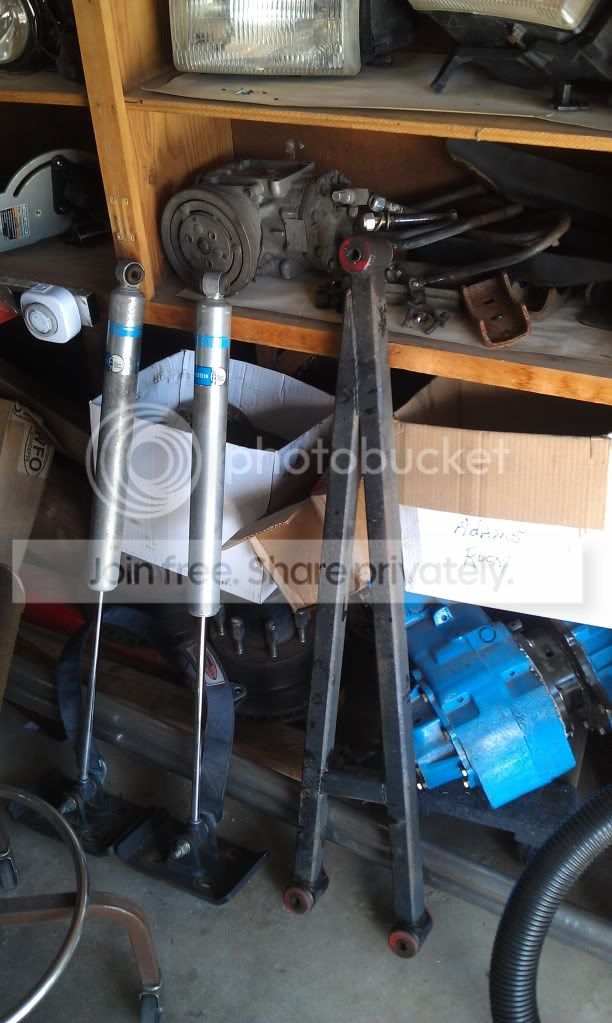

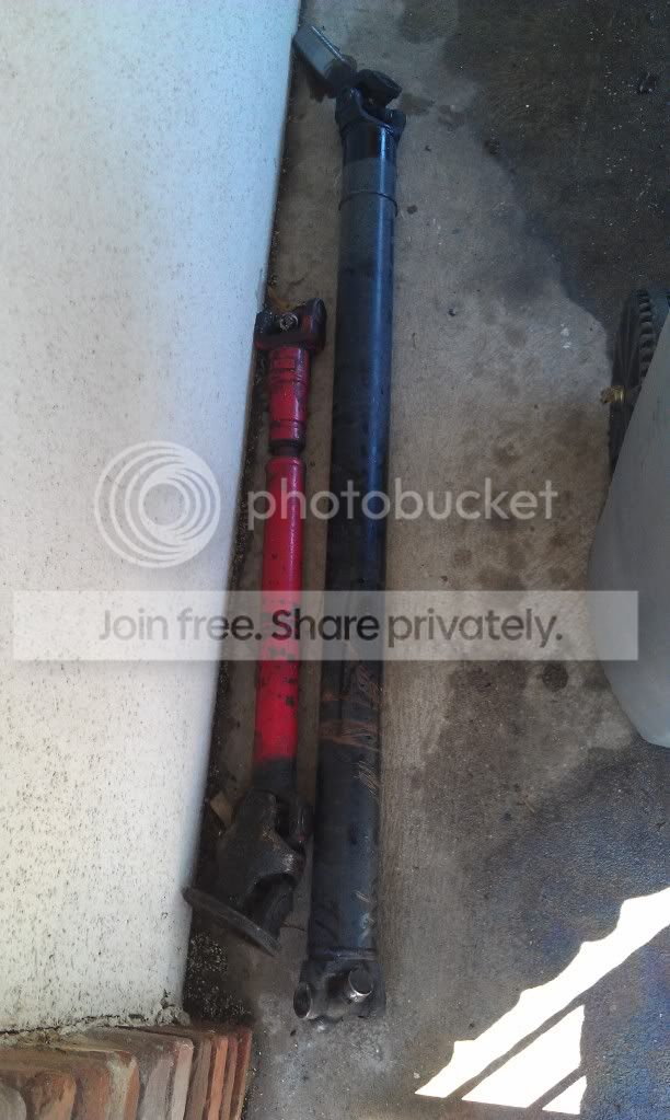

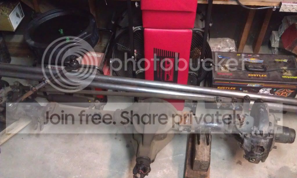

Got the axle out, traction bar out, rear d-shaft out, shocks and the upper shock mounts off. I have some small stuff to do like engine mounts, changing the rubber trans mount for the poly mount I got and a couple more pieces of tube out back. During all that I'll get the axles geared up and the lockers installed so I can get it back on it's own feet again hopefully within the next couple weeks.
Looking good. Those jack stands are awesome!!! Nice work. I need to come up there and wheel with you guys this summer!
