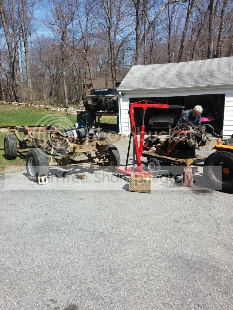

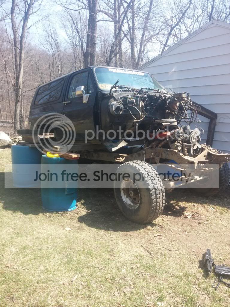

The truck was awsome but i became bored and wanted to do somthing different. I decided to start to pull the truck apart originaly to fix the cancer and to get rid of the baby motor and tranny.
[/URL][/IMG]

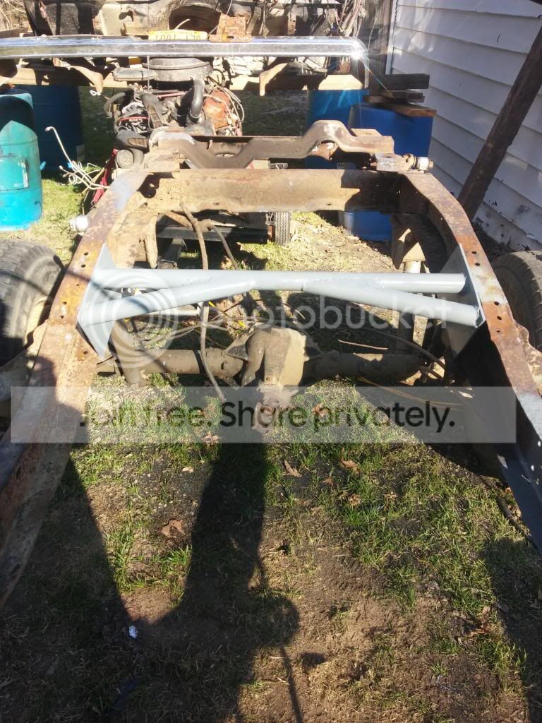

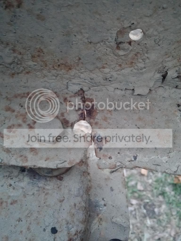

While tearing apart the truck i found some problem aeras that i had not noticed before there are some cracks in the frame and the cross member behind the transfer case x member was completly rotted out. Im not to worried about the problem aeras on the frame because i will be boxing and plateing the entier frame anyways (all plating will be done with 3/16th plate steel). But i wound up finding a lot more rust on the cab then i was expecting to find which means the cab is going to be going to the scrap yard. Pictured below is a crack in the frame near the tcase x member,and also the new mid x member that i fabed up.

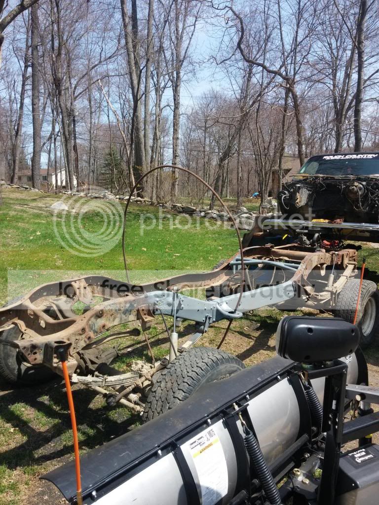

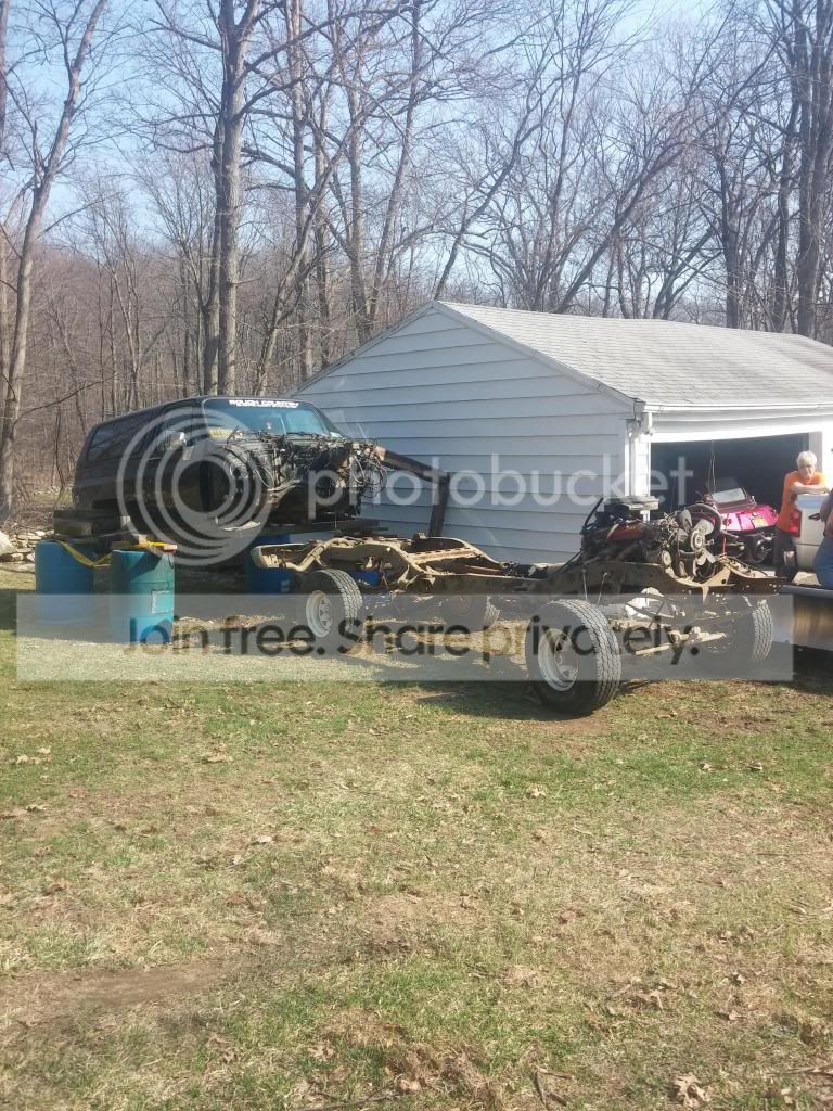

I decied at first to try and save money and decided that i would sand blast the frame my self but i do not have a compressor that can keep up to the task so im going and having a mobile blasting company finish the frame for me. Pictured below is the progress i have made so far and the way the truck sits as of today. Frame blasting is scheduled for next week, then its time for boxing :D .

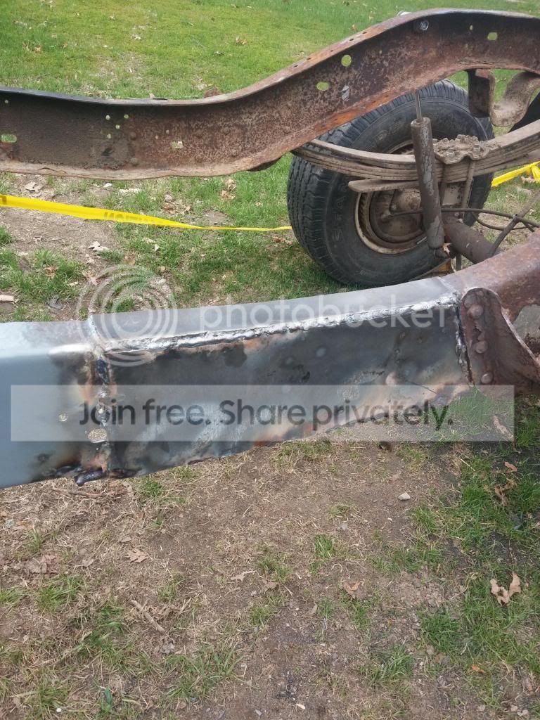

A little up date as of yesterday with that plating that has been done on the sections that ive sand blaster allready. (In no way am i a pro welder) i will need to do some touch up welding on final fitment but it is good as of now for where im at. The weather is not going here in NY for the next few days so thats where progress will be at for a while

I"m pretty familiar with how badly the salt can rust a frame, NY is very similar to MI in that regard, so not to discourage you, but if your looking for a decent body from the west, just trash this frame and get a solid one with the body your looking for...you'll be further ahead by starting with a solid frame instead of patching this one up here and there.
If you are adamant about keeping this frame, realign the frame rails to keep them parallel with each other, and also to keep the frame from twisting as you weld...it will happen!
When you patch the frame, cut fishmouth plates for the sides to provide more weld and penetration between the two pieces...also protect between the new and old metals w/ a zinc primer to prevent new rust from forming between the two pieces.
another good idea is to make a few holes in the new plate to do some plug welds.

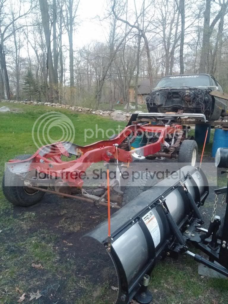

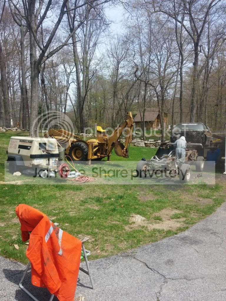

Hey guys got some major progress done on the project yesterday i wound up renting a 100 cfm compressor and 100lb sand blasting unit from a local rent shop i spent all day sand blasting away and got the frame completly done. It currently sits with temp paint on it just to keep it from rusting, once i am done welding the frame it will be cotted with bed liner.
[/URL]
[/URL]
Yes the frame is cotted in red, orange, silver, yellow, and gun metal paint because i ran out of rattle can paint.
