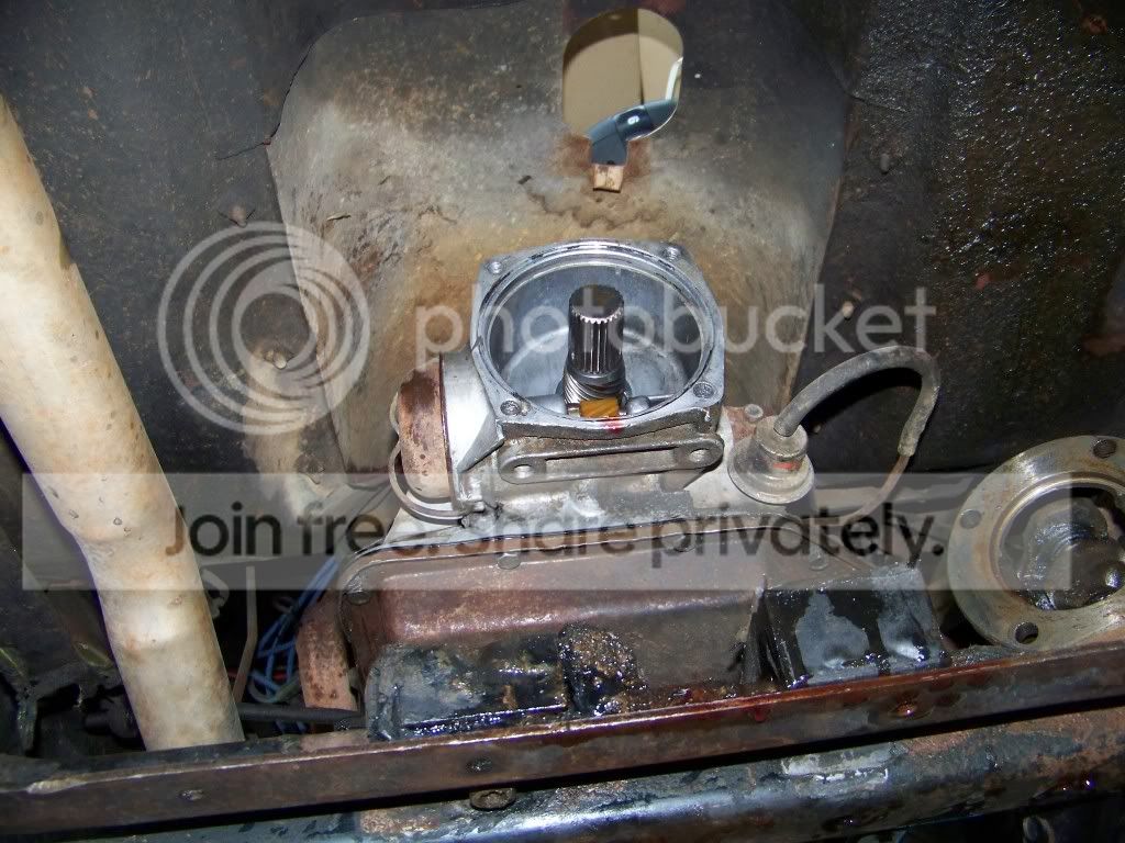

I have a T350 trans and NP 205 case. The NP 205 takes gear oil, which I use. I have changed out the transfer case fluid a few times lately and it always comes out red (ATF) I can smell the gear oil too, so it mixing together.
My trans fluid is somehow seeping back into my transfer case
What would cause this? Overfilling transmission?
I also noticed when I un screwed the top fill hole on the tcase – fluid stated coming out – a lot of it. So it’s also overfilling itself because I only fill it up until it starts to drip out of the top hole like I should. Any ideas?

The 2 seals in the adapter are bad. It takes about 4 hours to put new ones in.

unbolt the transfer case take the adapter off replace seals put back together
this one has the seals in backwards

Here’s the deal….. I dropped the truck off to a different shop to take a look as I’m done dealing with the other shop . The new guys have a good rep around town and seem like they know their stuff. They are also a Delco/GM shop. First thing they found is that seal was in backwards. I’m also missing some kind of support bracket on the upper passenger side of the tcase.
Then is gets worse…. Found out I have my turbo 350 trans is for a 2 wheel drive – it’s a 4x2 case. Apparently the PO used a 2 wheel drive T350….wonderful.
He said they could fix it up as is… all new seals and bands while they had it apart. But I should probably get a 4x4 case for the trans and get everything correct now. With my truck being a 4x4 and running 35 swampers it’s a matter of time before something happens.
