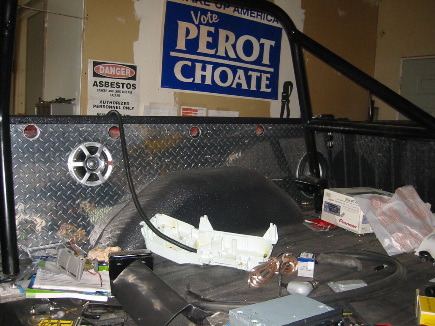

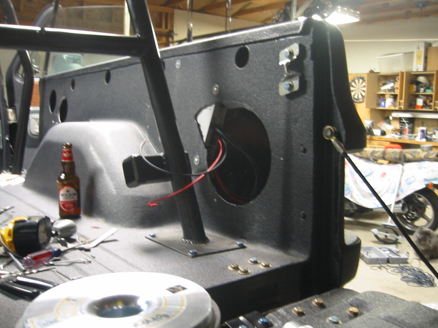

I have one 10" sub in my side panel. I, like you, didn't want to be overwhelmed or need or want thumping while sitting at lights. I just wanted some more bass in the sound when going down the road.
It is driven by a dedicated sub amp, a Polk C500.1 monoblock class d amp, rated 350w@4ohm, and 500w@2ohms. 2ohm stable amp.
I have an Infinity 10.1d DVC subwoofer (just 1) rated 350w RMS, (or 175w per coil). each coil is 4ohms. 1400w peak (or 700 peak per coil). I did build a cavity of the proper side in the side panel itself,completely under the side panel, sealed section that the sub sits in.
Together with an older (2005ish) high end Pioneer head unit, polk 4 channel amp driving 4 polk speakers, it is exactly what I was looking for. Clear, clean sound, with bass, top on or top off, low speed or high speed.
One key element, I think, bass seems to vary in different songs and sources, I'm very glad I installed the available remote bass adjustment knob that came with the amp. It's on my dash, can turn it up and down at will.
You can see the amp mounted within the cavity.
Sub toward the right of the picture, partially obscured by the roll cage.
