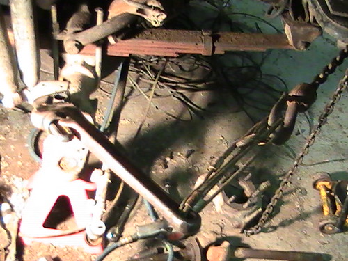

i managed to get the allen at napa so that wasnt bad for me, accept i have the axle out of the truck so heres how i did it, and it worked damn good. (it did get a little nerve racking theres a huge bang then its free, i did the first and almost $h!t my pants, the anticipation for the second one as you can see from my expression)
then for torqueing them down i just kept flipping the axle on the jackstands so no matter what the pipe was being pushed down, me and my dad ripped on it for about a half hour, until the cones didnt move anymore then we figured it was good and tight
