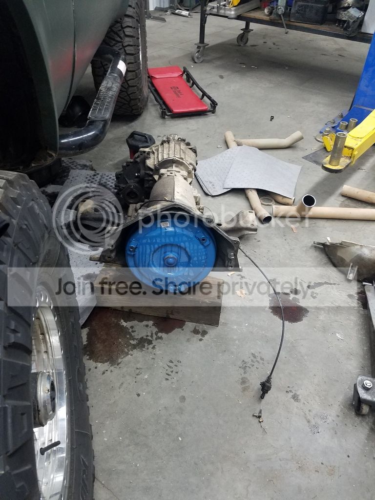

My Tv cable showed up today. any pointers on this retro fit
Got the same kit on mine. Be sure to follow the instructions as they are very complete. The install of the included tv valve spring in the valve body is critical. The cable adjustment once installed is a little tricky, as my initial adjustment while feeling tight, was not tight enough. Trans wouldn't upshift. My tech adjusted it up and got it shifting. I'm tempted to hook up a gauge to the pressure tap on the trans though to see if I need to go just a little more or confirm if the adjustment is correct.
OK thanks. I have a set of pressure gauges from Bow tie over drives that my buddy has. I will them for adjustment

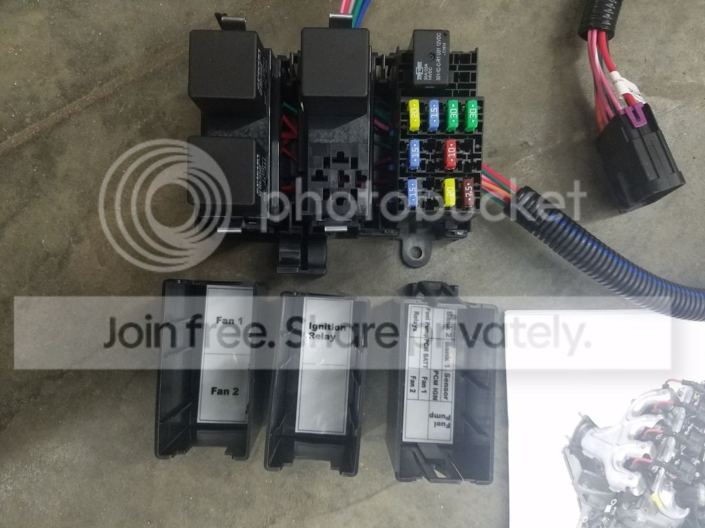

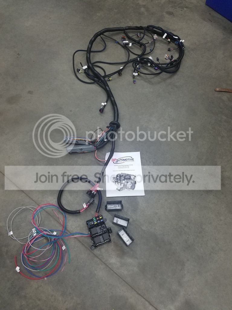

also my wiring harness from came. very nice products

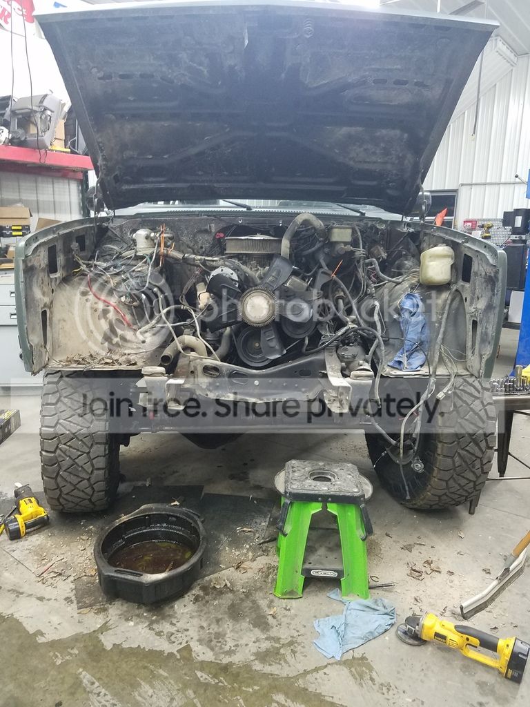

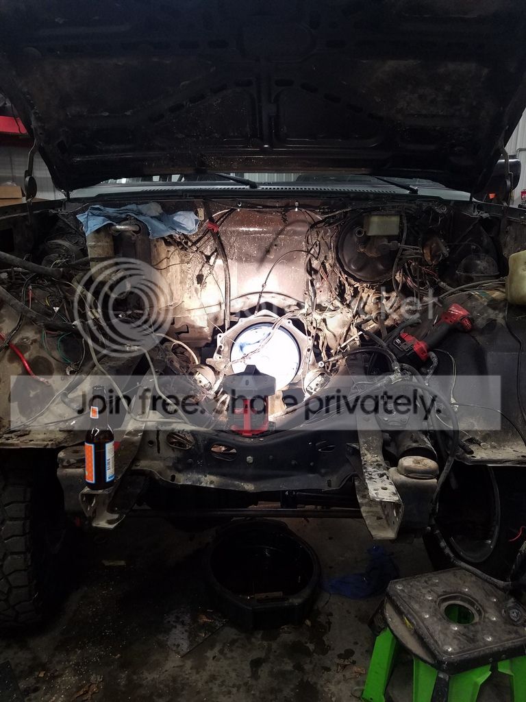

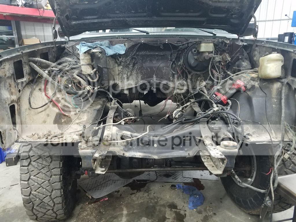

Today consisted of tear down of the old drive train. i got it all removed and now its time to clean up the engine bay. is there any way to tell what wires do what? i am good at ls swaps but not well versed in square body factory wiring. is there a diagram to follow for factory wiring?
Get a factory Wiring manual. Worth it's weight in gold. You'll know what you can flush and what needs to stay.
Oh, power wash and paint that engine compartment while you are there! It's totally worth it when the swap is done.
