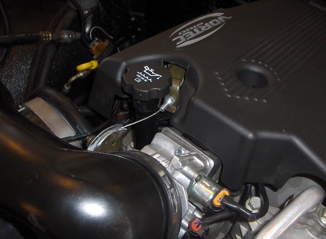

- 2003 brought a new design throttle body with a much smaller motor. This seemed to help address the touchy throttle on previous years. The harness connector and TAC modules are different between the early electronic throttle body and later. Make sure you know what you have before ordering a harness.
- 2003 also brought new bare aluminum valve covers

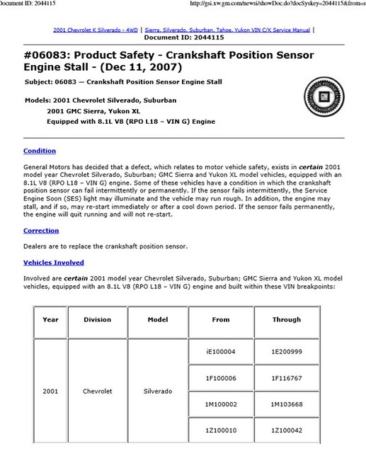

06083: Product Safety - Crankshaft Position Sensor Engine Stall: December 2007

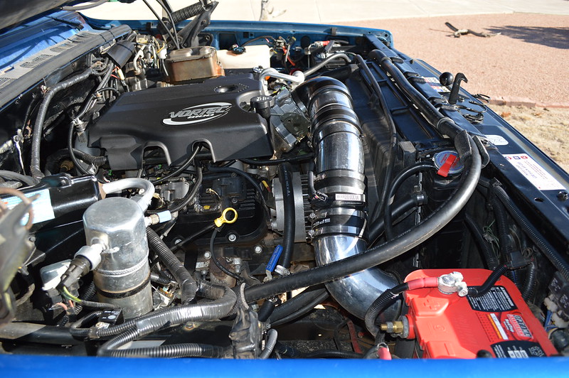

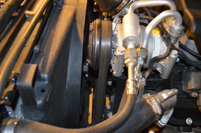

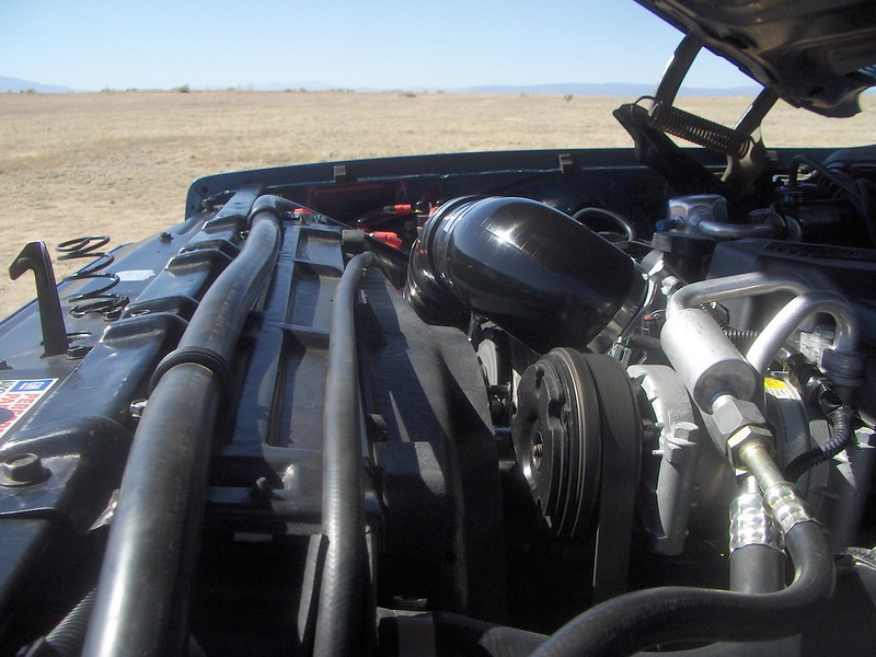

When swapping one of these engines into a 67-72 or 73-87 (91 square body) truck, the ORD HD engine crossmember works perfectly to address oil pan clearance. Taking a torch to the stock crossmember is just hacky…buy a nice ORD piece. Don't be a hack :eek:
Swap info:
- The L18 8.1L has the same foot print as older BBC engines and will bolt in the same as any other older SBC and BBC. In fact, the L18 will accept any exhaust manifold or header from older BBC engines. The starter motor from any older SBC and BBC for use with a 168 tooth flywheel will also fit the L18. Any transmission from an old PowerGlide, TH350, TH400 to Allison, to NV4500, etc. will bolt on to it as well.
- It is not required to run electronic throttle control on these engines. If you choose to keep it simple and reliable like I did, you can use a 1996-2000 L29 7.4L cable operated throttle body on the 8.1L. Cruise control could be adapted to mechanical TB buy using the cruise control controller from a L29 as well. An aftermarket TB spacer is required to be able to use the L29 TB in order to allow room for the arm to swing.
- These engines love higher than spec fuel pressure. Crank it up to about 67-68 psi and watch it come alive! (The adjustable fuel pressure regulator makes the early 2001-2003 fuel rails more desirable).

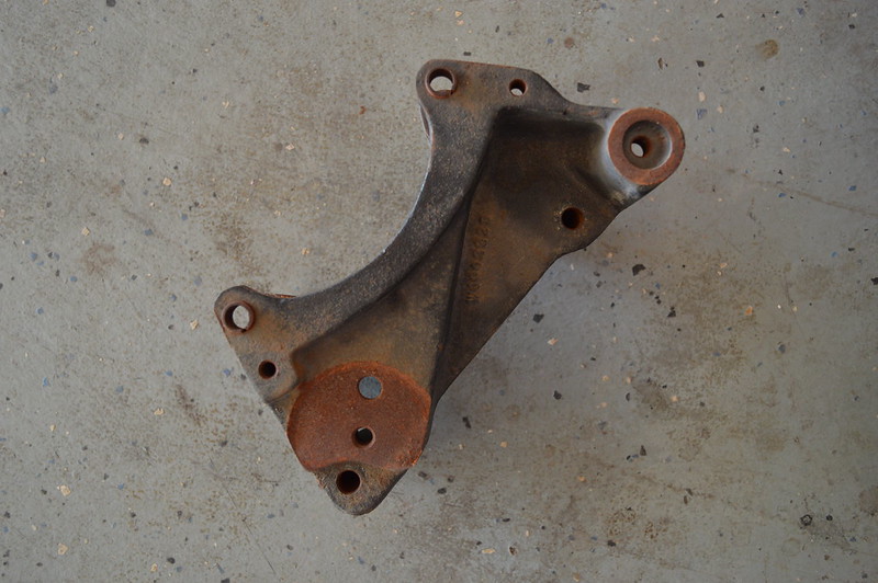

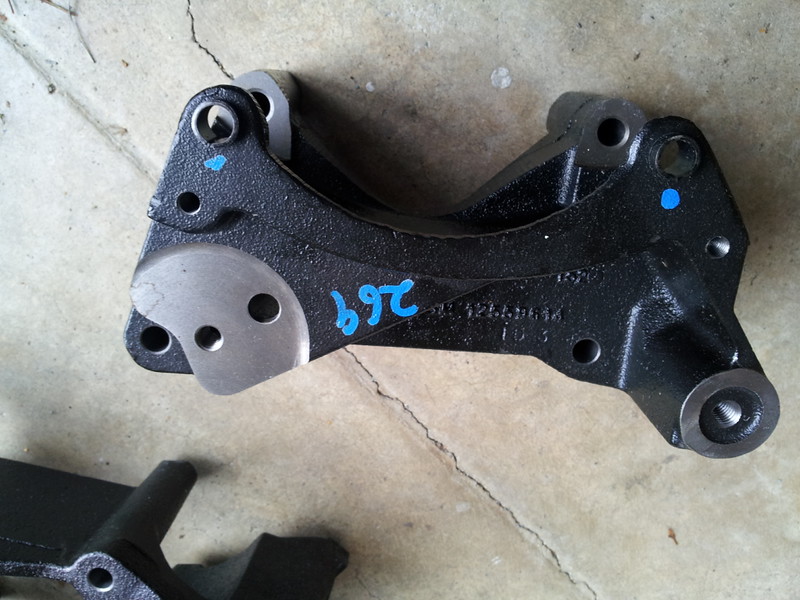

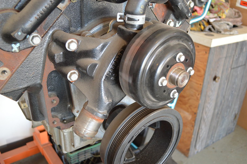

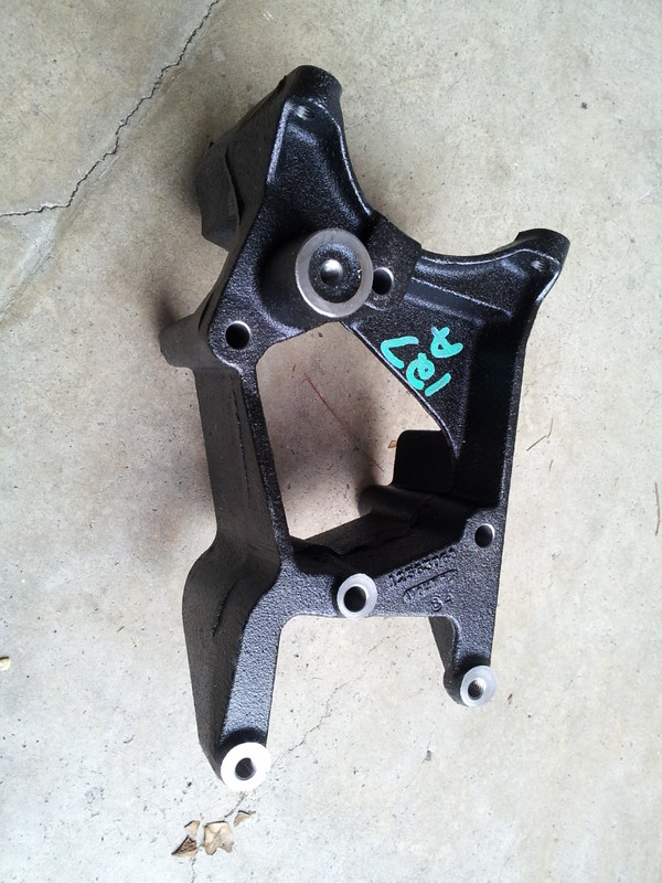

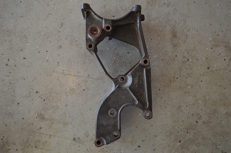

- There are several accessory bracket designs used on these engines. In my experience, the G-van/Workhorse/GM Medium Duty accessory brackets are ideal for swapping into a vehicle with A/C as the A/C compressor is located up high on the driver’s side whereas the Silverado/Sierra brackets position the A/C compressor down low on the passenger’s side which causes a major frame clearance issue during swapping. To convert a pickup truck L18 to the the high mount compressor design the water pump, crank pulley/balancer must be replaced as well. Don’t be that guy to hack up a frame to make room for the A/C compressor! If not running A/C, the Silverado/Sierra brackets will work fine. More information on that below.

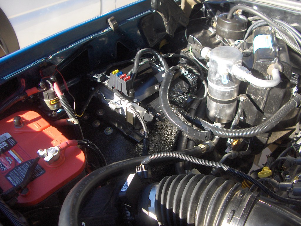

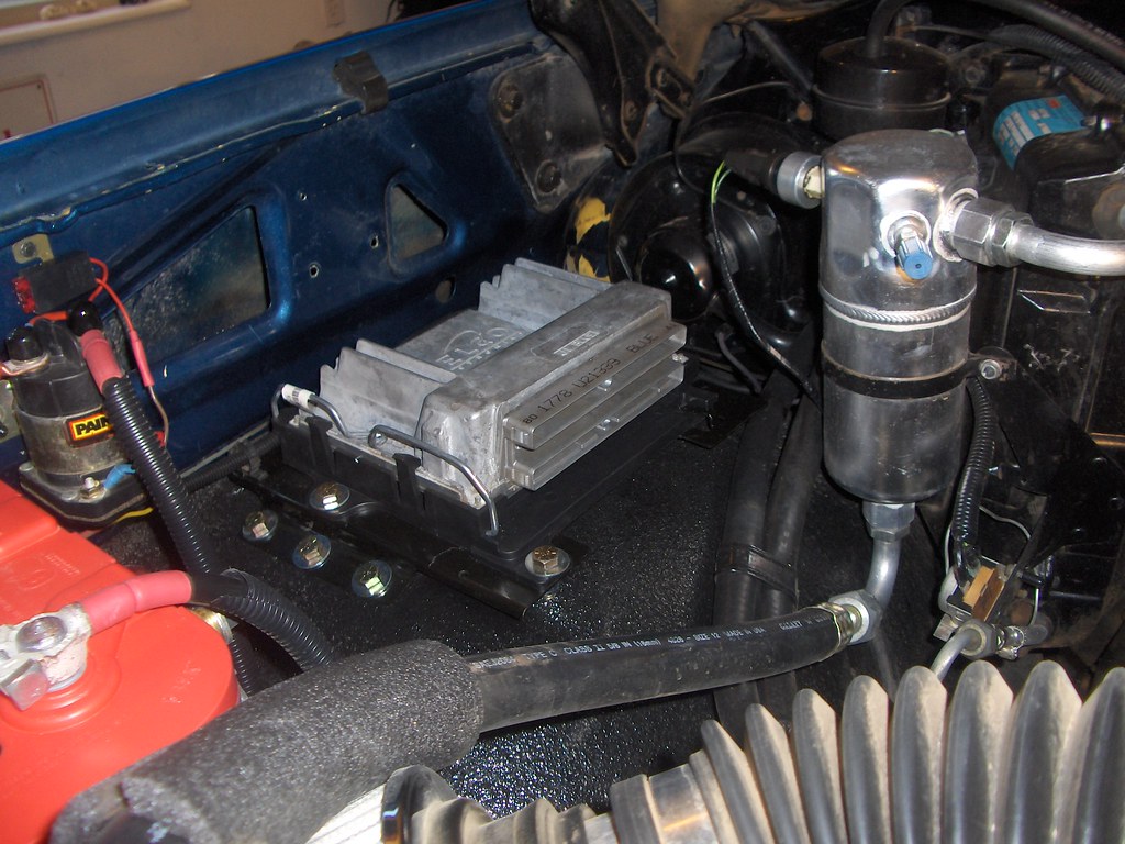

Wiring: Like any late model engine swap, there are many different avenues for wring these engines. I personally do not like going the route of reworked donor truck harnesses. There is just too much that needs to be removed from a donor harness to bring it down to a manageable/clean size and the margin of error while rewiring it is just too great. In my opinion the only way to go is start with a fresh stand- alone harness from Howell Engine Development or one of the many other good harness suppliers out there.
Identification Photo’s:
This is the most commonly found accessory bracket design, as it is the Silverado/Sierra setup. The location of the A/C compressor causes frame interference when swapping into an older truck. If installing into a non-A/C vehicle these brackets are great. Just remove this compressor and eliminate the belt.
This setup moves the compressor to high towards the driver's side like older engines. This setup is found on G-van's, Workhorse and GM Medium duty. The power steering pump in this picture is a ZF, not the typical Saginaw type pump although a Saginaw pump will fit this type bracket. If you would like to order any of the pieces for this set up use VIN 3GBKC34G61M101958 for part number look up.
Same as above but with the heavy duty industrial/marine oil pan
Same brackets as above but with A/C delete

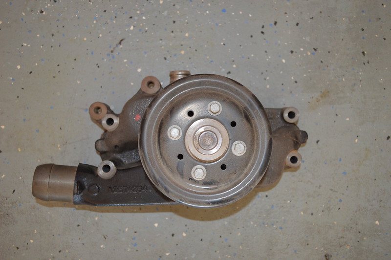

Water Pump: First, this truck water pump needs to be removed
Then install this water pump. Notice the water outlet is in a different location similar to the old SBC and BBC engines. The water pump length is also different from the Silverado/Sierra WP. Napa part number for this water pump is WP 58565 (reman) or TFW 44089 (new)

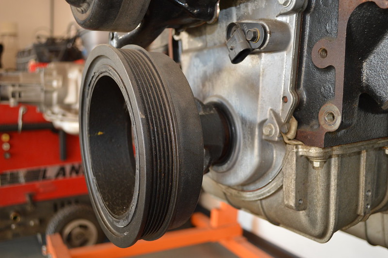

Crank Pulley/Balancer Assembly: Next step is to replace the Silverado/Sierra pulley/balance with this one. GM Part number 12555140
A/C-P/S Bracket: This is the A/C - P/S Bracket for use with a Saginaw PS pump. GM part number 12558927. It looks just like the L29 7.4L bracket but the bolt holes to the block are in different locations. A L29 bracket cannot be used on an L18. No idler goes in the idler provision unless you are running A/C delete. This is the bracket I run on my K10
Update: April 6, 2019: See post #417 for updated information on alternatives to the extinct 12558927 A/C – PS bracket
There is also a similar bracket to the pictured above but only allows for a ZF PS pump. Notice how square the PS pump mounting area is. Do not use this bracket unless you plan to run a ZF pump. From my experience, the ZF pump does not fit in the frame rails of older GM trucks. GM Part number 12563068.
Alternator bracket: This is a Workhorse alternator bracket, Part number W0003928 which accepts a CS-144 alternator. This is the bracket I run on my K10. The belt tensioner part number is 12581203 and the tensioner bolt is 11516367 and the idler pulley that bolts on this bracket is 12580771
There is also an alternator bracket of 12559613 that was used on G-vans and medium duty. I do not know what is different about this one vs. the Workhorse bracket above but they carry different part numbers.

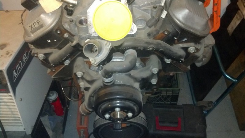

Coolant Crossover: This is one part you do want from a Silverado/Sierra engine. The coolant crossover in this picture is a the G-Van/Workhorse/Medium Duty piece that puts the upper radiator hose/tstate housing in a horrible spot, right in the middle of the engine. If you need a Silverado/Sierra crossover the part number is 12578330
The Silverado/Sierra crossover (12578330) will put your upper radiator hose here
Dual Alternator Bracket (12563070) This bracket looks to work with the Workhorse, G-van, Medium duty water pump, crank pulley & A/C compressor

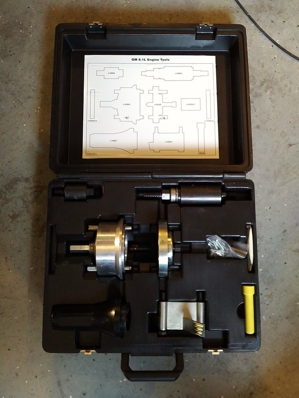

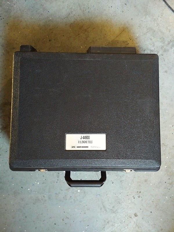

Kent-Moore L18 Essential Tool Kit: J-44900

1) The mechanical throttle body you want is on the Gen 6 454 engines - it will bolt right on - but you will likely need a throttle body spacer to make it fit. Here is one on Ebay - but you could probably find it cheaper:
http://cgi.ebay.com/ebaymotors/96-99...Q5fAccessories
Note that these throttle bodies have the TPS in the side.

1) I would replace the spark plugs, wires, and crank sensor and that’s it. These engines are simple and usually free of any oil leaks. The Early 8.1L crank sensors have a habit of failing so definitely get a new one. All crank sensors from GM parts have been superceeded to the new design. Once you put the 8.1L engine in an old truck you will not be able to replace the sensor without removing the engine so do it now. The sensors are around $65 but I don’t have the part number for it.

Good call on crank sensor - mine went out in my '02 about 2 months after I bought my truck.

Question I've been wondering - how did you plumb your AC to get from driver side top to passenger side firewall hook up?

As far as the A/C lines go, you’ll just have to have a hose shop custom make a set. My local Napa made mine.

Larry, I've got some questions.
What is this part? W0000393
HOUSING ASM - PCM
Between what you listed and were quoted, there are three alternator bracket numbers. I've confirmed the 12559613 was used on the Savana. Are the two Workhorse numbers the same?
W0003928 Alternator bracket (Workhorse)
W8800110 Alternator bracket accepts a CS-144 alternator (now we know this is the alternator part number, not the bracket)
12559613 Alternator bracket (GM)
Are the engine cover and oil fill numbers the revised parts with the offset fill that does not foul the throttle cable?
HOUSING ASM - PCM
The Workhorse W0000393 ECM housing is the plastic piece the ECM snaps into.
These part numbers make up everything in this picture below that the ECM is mounted to. This is actually a Workhorse ECM mounting setup with provisions for an Allison TCM on top. I just used the TCM bracket as a cover per’se.
15764028 BRACKET - PCM
W0007848 BRACKET - TCM
15003790 x2 BRACKET - TCM legs
Figured the 12559613 was the G-van bracket, just not sure what is different between that one and the Workhorse W0003928. Would be interested in finding out someday. I see the confusion with the two alternator bracket part numbers. I goofed and provided the alternator part number instead of the alternator bracket :doah:. Whooops! Good catch! :waytogo: You’re correct the alternator bracket is W0003928. I fixed the post with the wrong part number.
Yes, the following part numbers are for the later design engine cover with the s-shaped oil fill tube. Glad you brought that up.
2003-2007 Engine cover/oil fill
12574560 Engine Cover
12567370 Engine Cover Ball Stud
12562957 Engine Cover Bracket
12562958 x2 Engine Cover Bracket Stud
2000-2002 Engine cover/oil fill
12560199 Engine Cover
(2000-2002) 12560199 on left, (2003-2007) 12574560 on right

Air Induction Pipe:
This one was a real PITA. For the first few years I used a stock Silverado air intake pipe which looked like poop. I had helped another guy (Blake H) on the 67-72chevytruck forum where he figured out a pretty nice concoction of Spectre air intake pieces to fit the 8.1L he swapped into his '86 2wd Crew Cab.
I cannot find the my Summit Racing invoice that lists the part numbers I used when I redid the air intake but here is Blake’s list. I pretty much copied all of Blake's pieces except I used a K&N filter.
Spectre Performance part numbers:
1 x 9781 4" Rubber 90 (throttle body)
1 x 9799 4" 90
1 x 9831 Filter housing
1 x 9729 4" 22 degree pipe that goes over the alternator.
1 x 990003 Adapter for the stock MAF Sensor
4 x 9771 4" coupler
All those part numbers cobbled together look something like this. I also used a Spectre bracket that connects to the alternator bracket to one of the large hose clamps to add support to the long pipe from flopping around but I cannot find the part number :dunno:
