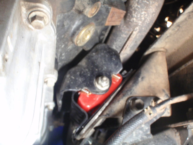

I prefer Energy Suspension engine mounts. They are very stout without feeling the harsh engine harmonics so many other aftermarket engine mounts are known for. These require OEM mount casings then remove the OEM rubber and install the Energy insert. My truck ate two sets of Napa engine mounts before I installed the Energy mounts. No problems after that. To make these work in a ’67 you may need to install ’73-’87 frame brackets though.
Energy next to China's finest Napa mount that has been ripped to shreads
Twice (one set a year for two years straight :rolleyes:) the Napa engine mounts caved in driving the oil pan into the ORD xmember. Luckily, it never rubbed through
