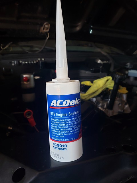

    I’ve never really looked at them at that angle. I’d say as long as the head has an opening for that chunk to fit in to you’d be fine. Actually, I do use the end gaskets on L29s and 8.1L’s as the new style intake gaskets are so much better than the old school ones but I do use GM 12378521 RTV in the corners. RightStuff should work fine too, its just a sumbish to get off later.

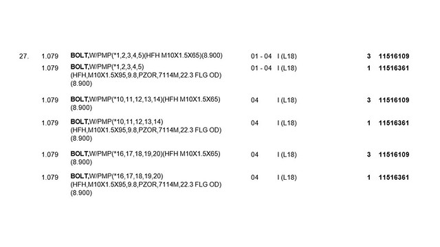

    Received my order with the water pump bolts in it - No joy. Those bolts are too short. I'll probably just measure the one that fits and order a standard bolt the same size. There is no listing for water pump bolts anywhere online. I suppose I could try my local dealership, but they are usually super expensive and won't give out part numbers.

    Here are the water pump bolt choices. Its basically two part numbers on this list, which the last bolt part number came from the Workhorse EPC. 11516361 or 11516109
    [​IMG]
    [​IMG]
    Russell, GWeakland620 and Capt Ron like this.

    Perfect! I'll do some measuring and re order based on that chart

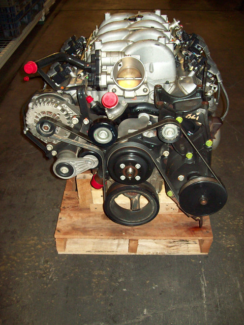

    If you have a pickup truck bracket with A/C on the passenger’s side all you need to do is remove the compressor and belt just like an LS engine (the compressor runs on its own belt). That’s it! Ez peezy....nothing to buy

    Now if you had a Workhorse/G-van/Medium Duty type bracket and wanted to delete A/C, just add an idler and shorter belt
    [​IMG]
