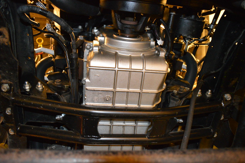

When it comes to using OEM style mounts and saddles on these, we recently learned is either work fine as one as the saddle and mount are a matching set from a SBC or BBC. Don’t use a saddle from a BBC and a mount from a SBC or visa versa or you’ll have mating issues. We learned that on Robs K5 8.1L swap
These are mounts and saddles with Energy Suspension inserts straight off the TBI 5.7 that the 8.1L in my 89 Suburban replaced.
