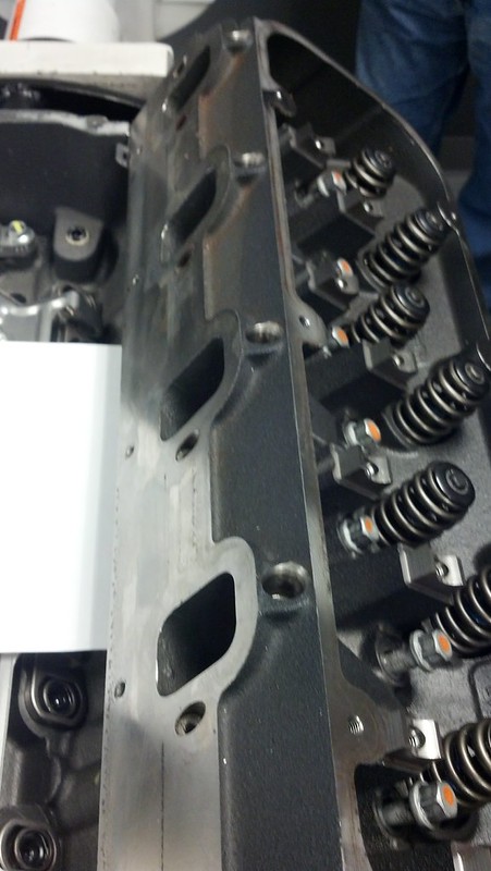

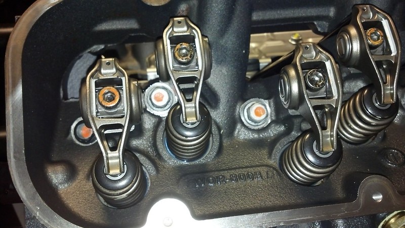

The 8.8L heads are pretty slick. I don’t have any pictures of the combustion chamber side but the valve train is straight off an LS.
Injectors moved to the heads and out of the intake
Nice rockers

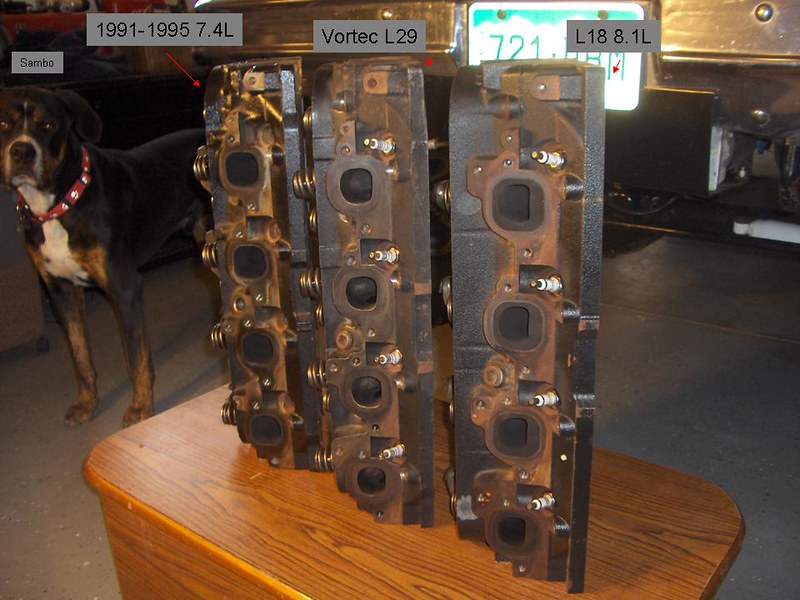

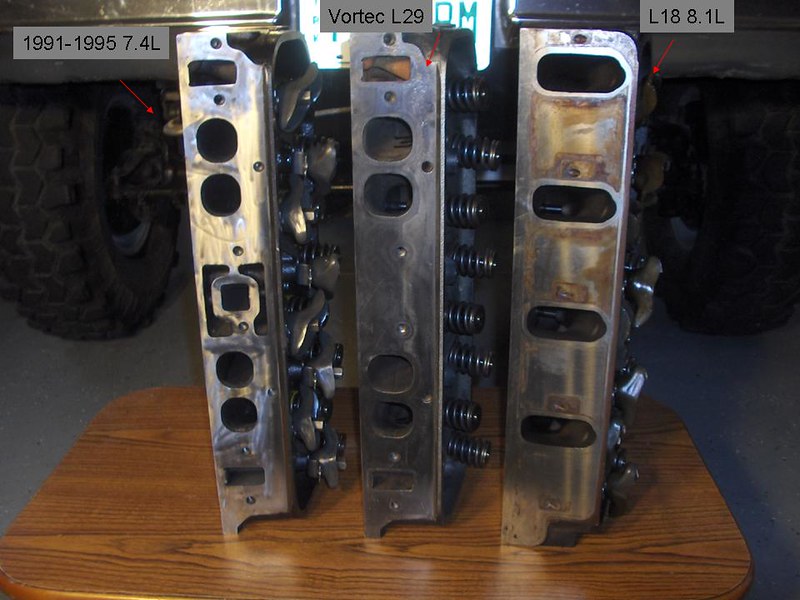

Yes, the 8.8L intake is its own animal and I wouldn't doubt the 8.0/9.0 Gen VI intake ports are their own animal too even though they list the ports as oval. Afterall, big blocks have had a few different "oval" ports over the years. Here are two flavors of 454 oval ports and I believe the older tall deck 366 and 427 had yet a different oval port size.
Yes, port matching can be done on the Gen VI/Mark IV type stuff, because the intake will still physically bolt up, obviously you need material to port. Those peanut ports of the Gen V were the worst ports for a BBC. The L29 Gen VI went back to the old Mark IV oval port, very close to it. Then you have the Rectangular ports of the Mark IV, but the bolt pattern was the same as the oval port.
The 8.8 looks to have it's own bolt pattern again, like a giant LS bolt pattern without the cathedral ports.
