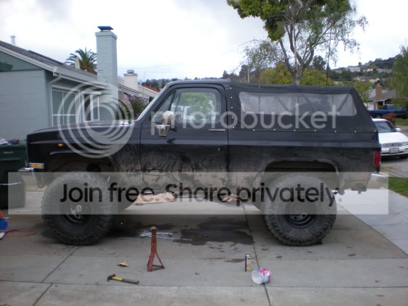

Here it is as it sits now. I needed to do some trimming to get it to drive. I need to get it out on a trail to see if I am going to trim more or lift more.
This is a 4in lift on 37x14.5x15 toyo muds.
