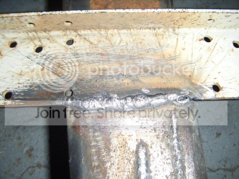

first, with the advice from Paul (ryoken), I started by laying some straight beads on a thick hunk of metal.
Then I said screw it, and found a piece of scrap, ground it clean, and layed a bead down.
So, how am I doing?
Is this stick or mig?
If mig I'd say you have way too much contamination or the tips are the wrong size for the wire or worn out.
little to fast.
and back feed a tiny bit at the end to prevent the puddle/hole you have there.
and you want more of the heat/time welding in the thicker metal. you can see good fusing on the thinner plate. and more of a square edge like its sitting on top of the metal for the thicker stuff.
so if you have same thickness it would be 50/50 split of the welding on both . and your second pic is thicker ond thin plate. you need to put more heat/time/welding in to the thicker stuff to get good penitration.
i thing i always tell people the most overlooked area is, prep work. i always use a grinder or flap wheel and not a wire brush anywhere i am going to weld and for where ever i am attaching my ground. you get a much cleaner "bare metal" surface to start with and it really make a difference especially with a mig. and like twoslo450 said i also like using the half moon or "C" motion. what kind of mask are you using? if you dont have one and plan on doing any amount of welding an auto darkner is the only was to go, and a adjustable one is even better! good job so far, get some scrap in various thickness and practice with different heats and welding different angles. welding on flat and vertical are totally different techniques. :D:waytogo::waytogo:

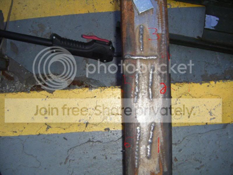

My first real project will be welding up my exhast. Any tips?

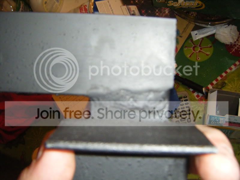

Heres a weld going perfectly straight. It's on the left small rectangle on the top.
And for the exhaust, what size is your welder? With mine I would probably stitch weld it, which is also know as the tack tack welding method

I still think it's the machine, the wire and tips match right? How does it sound when it welds? Is it smooth and crisp? Maybe take a video of your weld.

The site I gave you should answer most of your questions about welding exhuast. stitch welding would probably be best, unless you can keep from burning through.

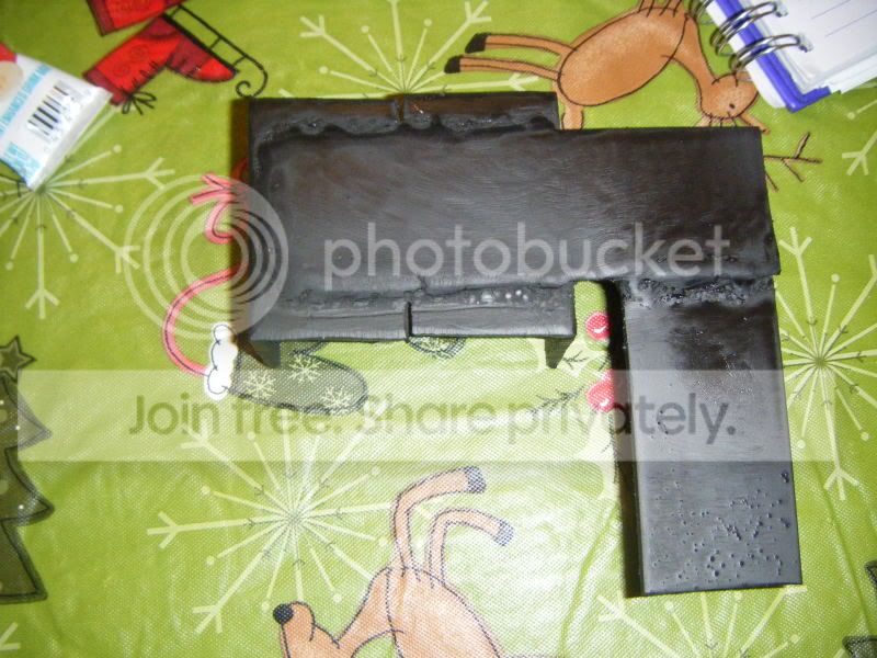

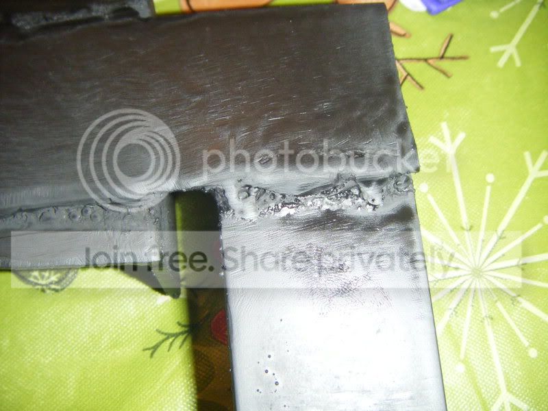

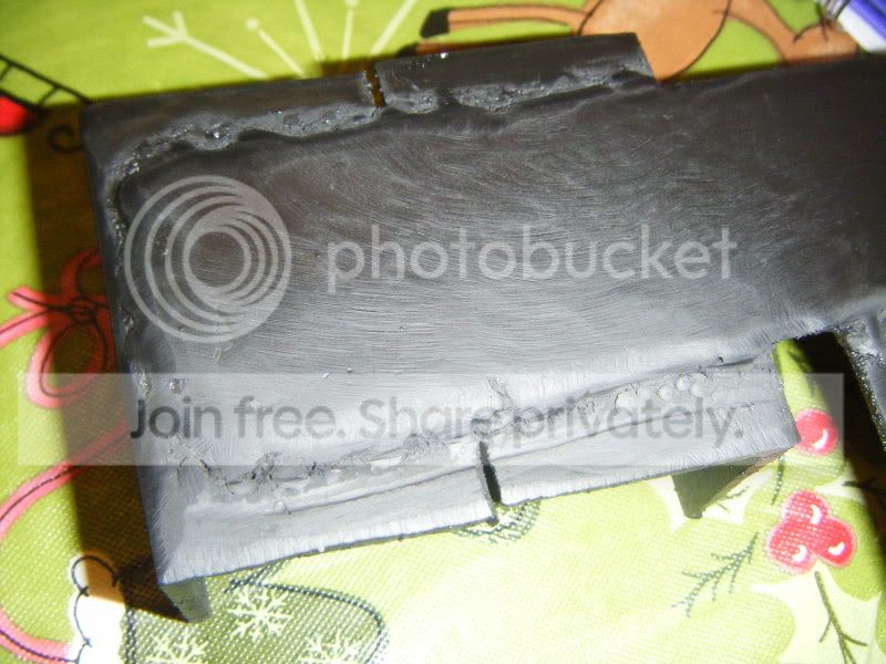

Any good? This is my passenger side radiator mount. I did half moons on all the welds except for the one ontop of the flat stock going to rad support (3rd pic), not sure what happened there. It got good pentration for sure as it got red hot!
I think I need to clean it up a little better, don`t think I can too much more though...
When it looks like the inside of an "aero bar" it's not good. I see a lot of "aero bar" in those pics. It's known as porosity, and indicates some sort of contaminant, or lack of shielding going on. Welding over rust, paint, oil etc will do that. For single shield flux core (gasless wire) the smoke is a lot of the shielding...it displaces the oxygen in the arc. If your 'stick-out' is too long it can be a problem.
Stick-out is the distance from the contact tip/edge of the nozzle to the puddle. Shouldn't ever be more than 5/16"-3/8".
Rene
Still looks like you still need to slow down a fair amount, get the tip in closer too like Rene said. I kinda doubt the porosity is from contaminants, with flux core you can get away with a lot and still get pretty decent welds. Way more then with a gas setup
so is there something I should do to this piece or should it be alright? do I need to make it again? I still need to make the drivers side one, so I`ll have to try and adjust myself again....
