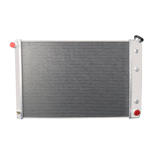

Seems likeca nice radiator. Web site is well designed and gives good information.
