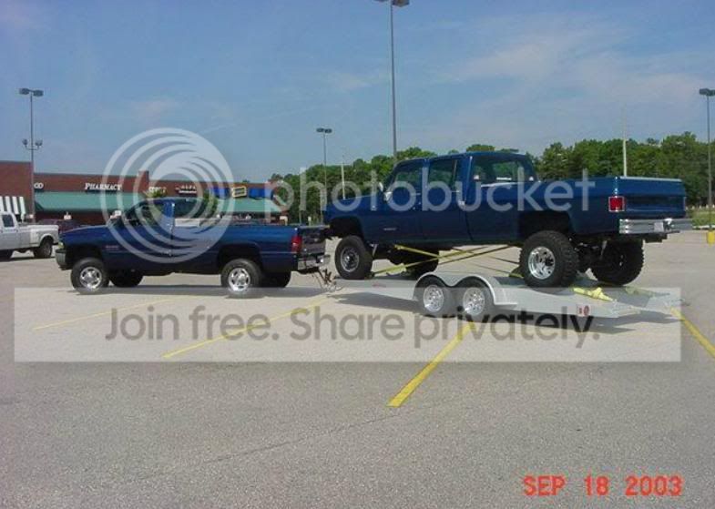

It's been a long time so the details are a little fuzzy but I think this was a 20' 7k trailer I borrowed to pull my old crew cab to the Indy Jamboree back in '03. Just thought I'd post it to give a little trailer length vs truck perspective.

Hey I know where that was at!:D
