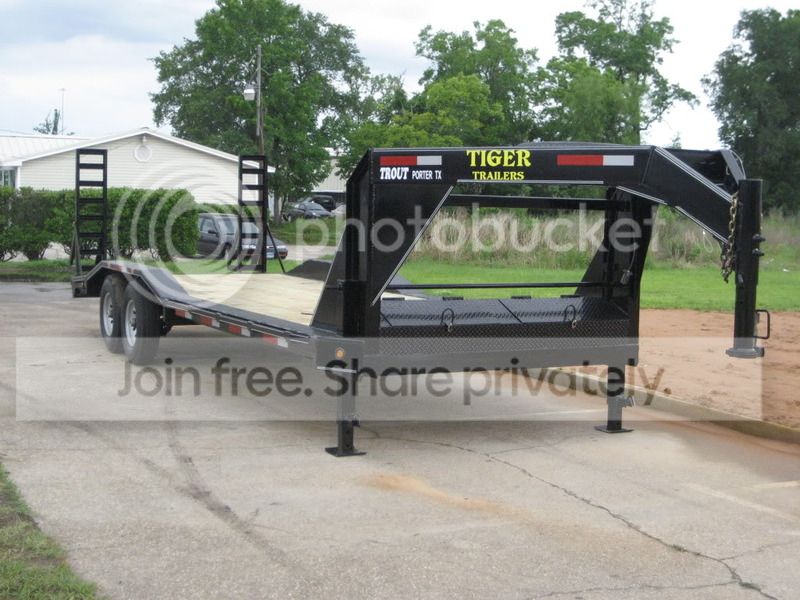

As far as buying a GN for $1500, it's either an awesome deal, or you'll wind up with something pretty junky. You'll probably need $3K or so, closer to $5K if you want tandem duals, which are badass.
I started building another GN last winter, but ran out of time before I needed a dovetail GN really bad in the field and never got mine completed. I went ahead and bought a Big Tex and payed $4500 for it, which is a steal around here. I've got another we built that has triples, but I like the tandem duals better, better brakes, more capacity, and longer life because the hubs and brakes are so HD.
