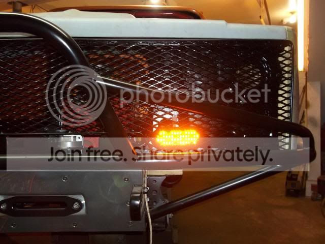

For the stop/turn signals, front park light, and back up lights I used: 45-LED Tower Type 1156 & 1157 Bulbs Back up lights are 1156 and the turn signal/stop/park lights are 1157

All the dash lights I got the Cool white color. All the others were the appropriate color for the application. Like it says you want to get the same color LED as the lens for best results. (so for the dash turn signals and high beams I got green and blue lights) Since the LEDs draw so little current compared to the normal bulbs I had to buy these 6 Ohm, 50 Watt resistors. The load resistors are required for the turn signals only and installation is easy as you don't have to cut any wires.

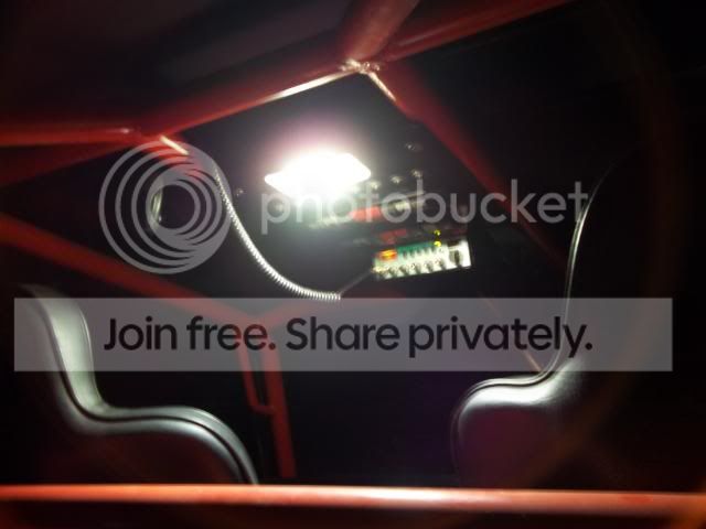

As for the dome lights I was looking at this: UPCB series Universal PCB LED Lamp with Mating Bases
I did notice two issues, One was with the front turn signals and front side marker light. By factory they are wired to wig-wag when you have the parking/headlights on and turn signal flashing. I had to rewire the side marker in parallel with the front turn signal so they both turn on and off at the same time because the LEDs in both lights draw too little power to do the wig-wag function anymore. Though the rear is not wired to wig wag like the front, I wired the rear side marker and tail light in parallel with each other as well. So now my side markers only turn on to flash with the turn signals. Hopefully they be a little more noticeable during the day.

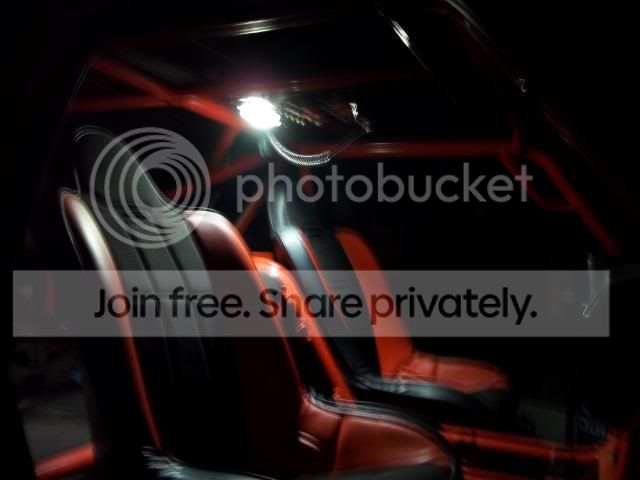

Heres a picture of my gauge cluster with the LED lights. I hope the difference is apparent here. The picture doesnt do it justice. (the temp gauge is blocked by the steering wheel)
I did both dome lights and footwell light and found that 1 of the 3 glows very dim with the doors closed. Actually didnt notice it until driving at night. I did the cluster lights and found that i cant dim them. Guess its becasue i need to add another resistor to get the voltage down low enough to make them dim. All the bulbs i got were from china on ebay and they been in for a few months with now problems
