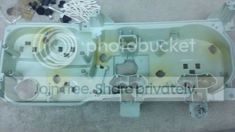

I've got the whole cluster out of the Burb right now. I'll have to check when I get home to be sure but if I recall in addition to the ones you mentioned there's 2 or 3 in the speedo/fuel gauge area, 2 more in the temp/voltage/oil pressure/clock area, another 4 for the dummy lights under the speedo and fuel gage and possibly one for the gear indicator if you've got an auto trans.

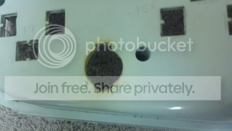

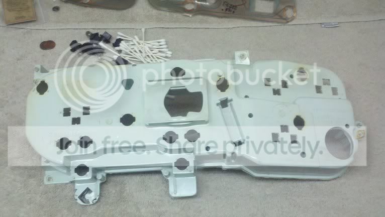

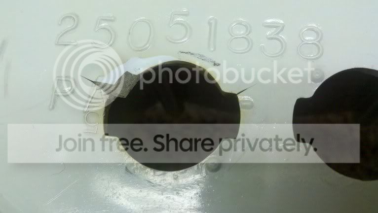

On another note, I also noticed in my cluster that there's a lot of darkening around some of the bulbs and some areas that look melted/heat damaged. I've never been into this cluster before so I don't know if the PO put higher bulbs in or what. I didn't think a 194/168 could put out enough heat to do any damage. :confused:
EDIT: Pics posted below.

I think for the whole dash you need 11 bulbs, if I remember correctly. At least thats what I needed for my '76 Suburban. I bought two greens, a blue, and a red for the indicator lights, then the rest are the cool white led bulbs. I think I counted 11 and that included the light switch lever and the heater controls. Now I need to note that the heater controls uses a different bulb than the guage cluster does. (my guage cluster is the speedo, fuel, battery, oil, temp and park brake indicator set up)
Chris, the filament bulbs do get quite hot, I've noticed on my front and rear sidemarkers that they have melted the socket and plastic around them. That was one reason I decided to start converting to LEDs. I've seen some trucks in junk yards that there is melting in the guage cluster too, but not in my truck.

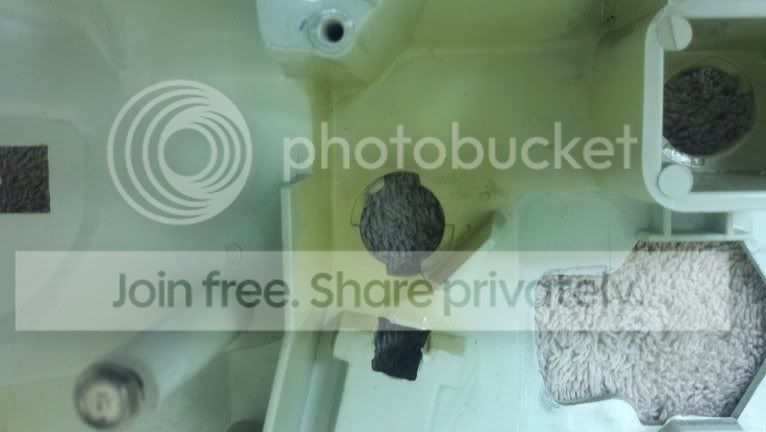

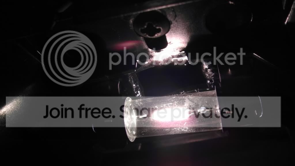

So here's the cluster for an '84 Suburban auto trans. The two lights unique to the diesel (water in fuel and glow plugs) are wired separately so they shouldn't change anything as far as I know. I count 12 bulbs total. That doesn't include HVAC control as it's all outside the cluster. Also note the socket furthest right on the top is the special socket with the fiber optic cable that goes to the glove box.
You can see the heat damage around the sockets. A bunch of them have hairline cracks on the edges and one was cracked/warped enough that it wouldn't hold a bulb at all...I had to reshape the lip with epoxy. It holds the bulb great now but we'll see if it can stay together for any length of time.:crazy:

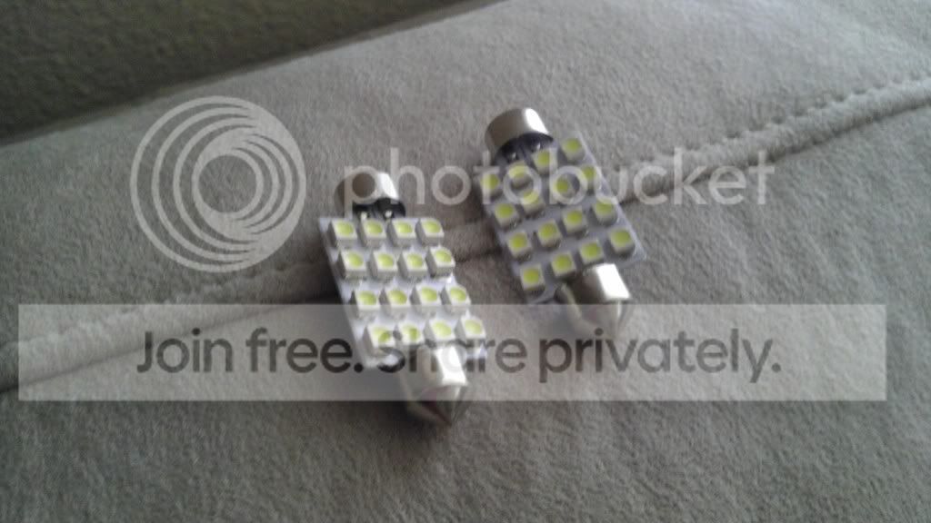

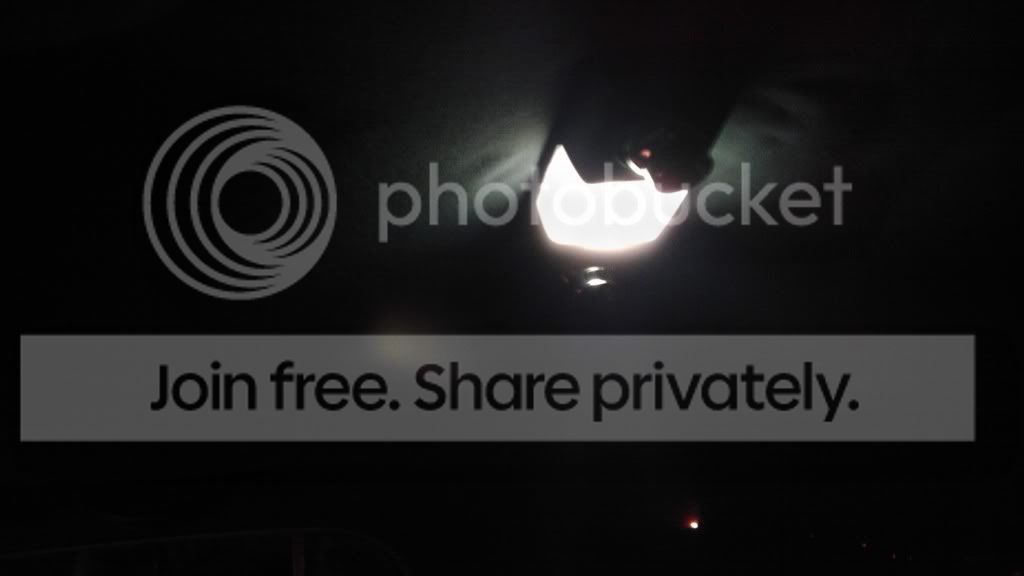

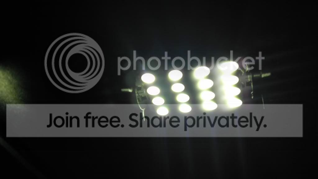

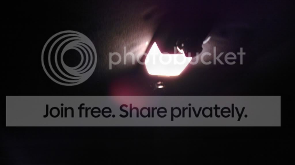

I just got these today. They were $3.19 with free shipping for the pair off ebay. They are for the dome lights in the burb. Not sure how bright they will be but a figured for $3.19 it was worth a shot! Going to go try them out in a few now that its dark out.
Well i dont think they will stay. Little too florescent of a light. IF its any brighter i cant really tell. I can tell you one thing though, those incandescents are freaking hot!!! Literally burnt my fingers!
Incan.
LED
incan
LED
Seat shots trying to test brightness.
incan
LED
Over all shot.

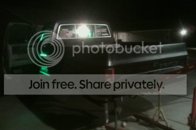

Yeah id say they arent much brighter. Mines bright as hell but the stips are noticable and most people.wouldnt want green lighting. I do cuz its a toy anyway and it looks cool. Haha i think you can get the kit i have in white and that would make for one bright cab....
