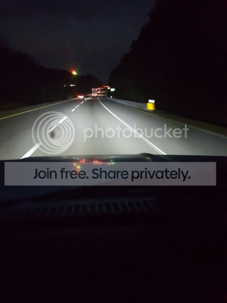

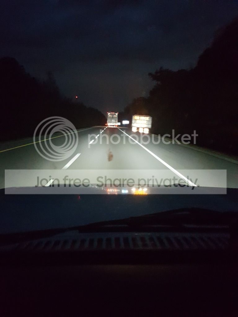

We'll, I'm on the road...stopping for dinner anyways. Here are some low beam pics on the highway.
