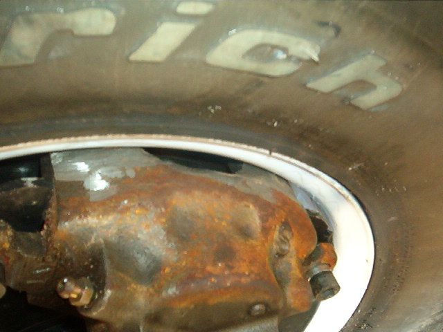

    I am running 15X10 white spokes with 4.25" backspacing. It took about 3 hours per side to do the grinding and hammering. :eek1:

    I run 15x10's with 4.25 inch backspacing. That grinding was a bitch. I think it took like 4 hours to do both sides. My hands hurt and I didnt want to see a grinder for a looooooong time!!! And I was tired from moving that 35" tire on steel rim. But it works. Just :grind: then when you want to test fit just :grind: some more.

    i just ground off my caliper i put my 15x10 wheels with 3.5 backspaceing on and they woulent turn not even with me standong and grappling to the lugs of the tire it took me like 3-4 hours to grind off one side no digi cam so i cant take pics to help you >.<

    sorry no picture of just the caliper, but thats a 15x8, 3.75" backspacing, I can grind the calipers in under 30 minutes now, with just a 4.5" angle grinder. After you do a few, you'll get the hang of it, they crank out pretty quick.
    I'm not even removing 1/4" of material, and it clears just fine.

    I have done a few. The best way I have found is to turn the ginder on it's end and cut a line around the caliper 1/4" deep. Then all you need to do is remove the rest of the metal to the end. Also if you can have one of your tires unmounted from a rim it will make it easer on your back. A paint stick will help out a lot, to see the rub if any.
