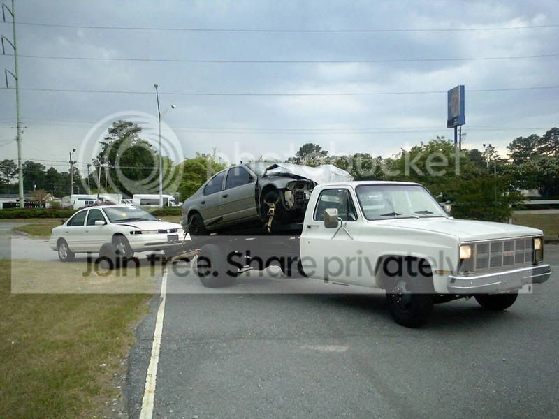

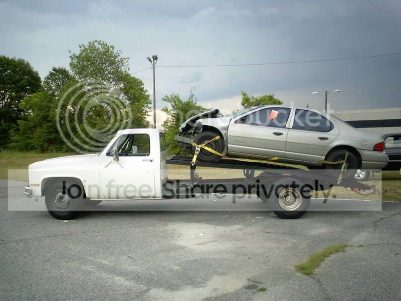

here is my "cow"... i dont know how it got that name, but it stuck for some reason.... i transport salvage cars w/ it... works great....

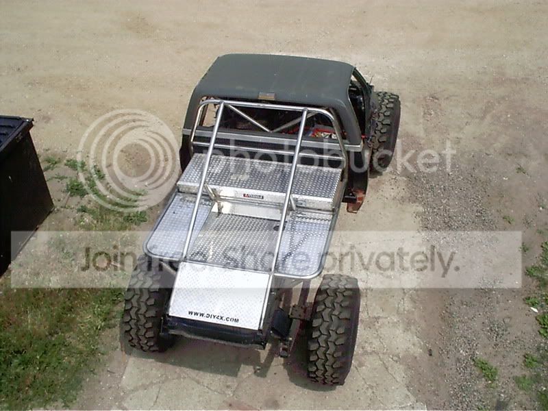

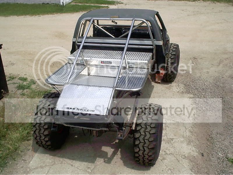

Thanks for the comments!!!
2"X3" rectangular frame. All of the round tubing is 1 3/4" X.120 wall. The tool box is for a small ford truck, maybe a ranger??? (it's narrower than a full size anyway) The fuel cell is located under the rear most angular tread bright plate. Air tank just in front of that.
It's not finished yet, a spare tire will be mounted just above the cut out lettering and will lay against the kicker bars and 2 fuel cans will be just to the left of the Ultima sticker on the tool box.
It is mounted to the frame just as a regular box would be. And I need bigger tires!!!

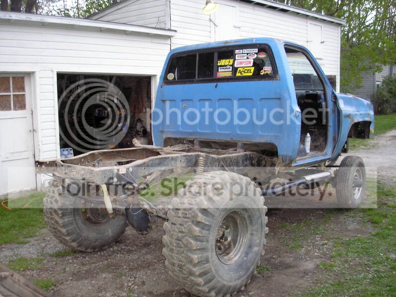

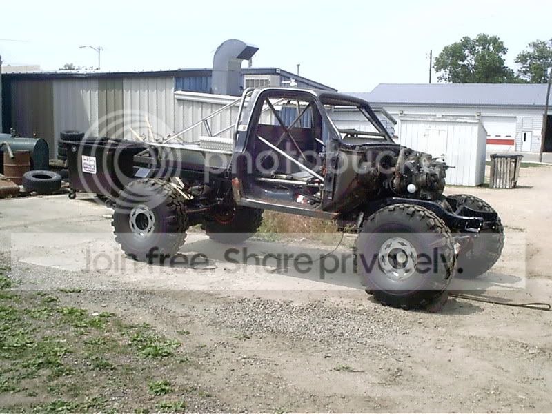

Couple more.
Same angle different height
Ground level
