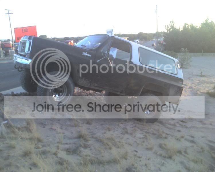

Don't leave me out, '75 model:
I really like how you didthe front bumper! I would like some more pic's of this please.
Is your front fender welded to the slider or did you make something for it to bolt to?
You do lose that bottom bolt, thats a customers rig that is shown we later welded a tab on the fender and tapped the tubing. I think a self tapping screw would work just as good.
