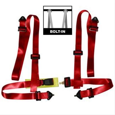

Don't know anything about harnesses. I'm not looking for anything extreme, maybe worried about a rollover on the highway. These look decent.
http://www.summitracing.com/parts/GRM-15-622/?rtype=10
thats the belts i'm looking at for my sons 72. they look pretty simple to get in and out of.
yea, I like the oem style buckle and the price. They should work fine in the prp seats, not sure about the blue one.
I am going to use those belts in my rear seats, my fronts have the harnesess that are more conventional. With the latch style so I can use just the lap belt if I want too
