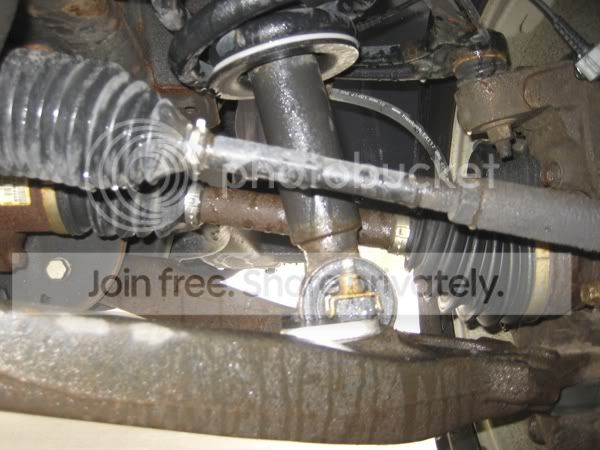

More pics.

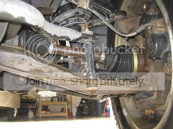

Before & After:
Makes you wonder why they don't do that from the factory.
Easy as we led you to expect?
Yeah it wasn't too bad, hardest part was getting the two bolts started back into bottom of the struts after the spacer was slipped in. But even that wasn't really too hard. The whole thing took me about 3 hours I'd say.
Just now got back from the alignment shop so I'm good to go. :waytogo:
yep, they said it was a piece of cake.
And I did have plenty of thread at the top of the strut to get the nuts on during the install. just couple of threads to spare above the nut. but they're on good and tight. :)

Did leveling the front change the angles on the tie rods or ball joints? If the kit did, how bad?
the camber was out about a half inch on each side after the kit was installed. the guy at the alignment shop said that it was an easy adjustment. definitely get it aligned after you install it. alignment cost me about $50.
Yes I would definitely get it aligned, I was curious after the spacers were added if they added any angle on the parts after the alignment.
you mean visually? I didn't really look at them before and after in that way to tell if there was a difference.
The angles are changed of course. You're forcing the suspension to sit lower down in it's arc of travel than it used to. Now whether or not that's damaging anything in this situation I can't say.
Craig, if you happen to catch a few minutes could you possibly take a picture of the angles or perhaps give me your opinion?
