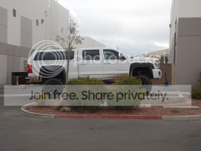

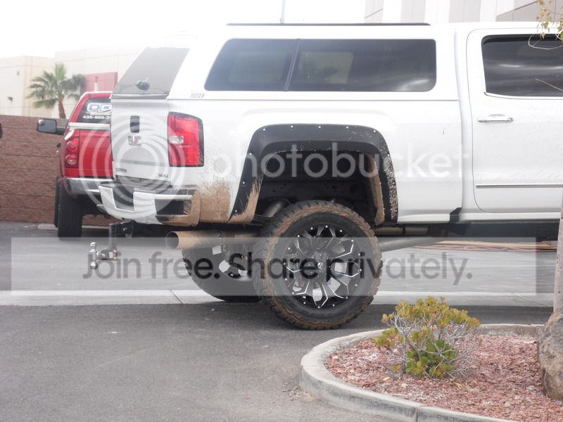

New Chevy wheelwells are kinda stupid. Look at this truck next door to us at work. This doesn't even look good to me.

Not bad.... That pic of the white truck is exactly what I hate... A foot and a half of space between the top of the tire and the top of the wheel opening and probably only has 4"- 6" of actual up travel. And tires way small for the lift.... Makes no sense. I may try that 2" level kit thing and see how it goes. I don't want to get too crazy with it really. It will currently do any wheeling I'm actually going to do anyway lol. Hate to say it but any lifting would all be poser look. Just my work truck and the wife's winter truck.
