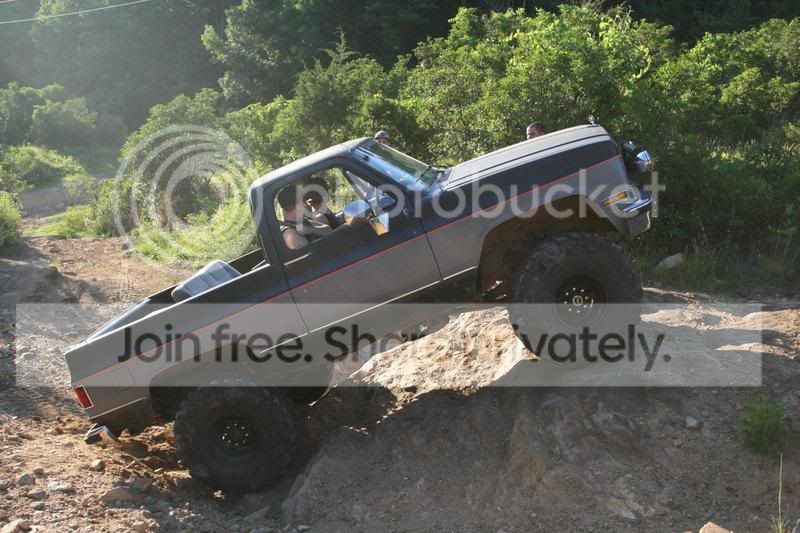

this is an older pic of my truck but it has the 6" with 2" body and u can see the front fender is trimmed back and i didnt trim the back in this one. but the tire caught it once and bent it a little so i trimmed that later on.

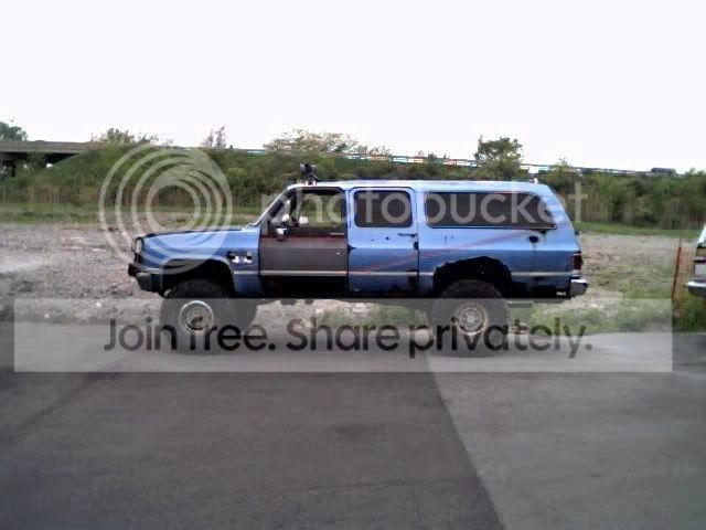

youll need to trim with a 6inch lift. heres right when i was about done with my suburban. 6inch lift and 38s not trimmed yet. if your realllllllllly careful and turn slow you wont rub but any kinda bump or normal speed turn they rubbed.

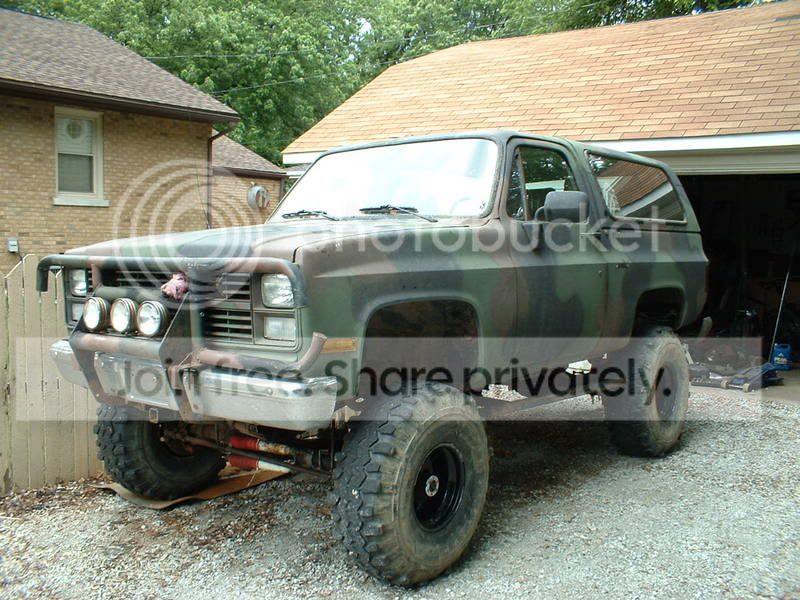

my current truck. same tires and suspention but with a 2 body lift. havent rubbed yet
