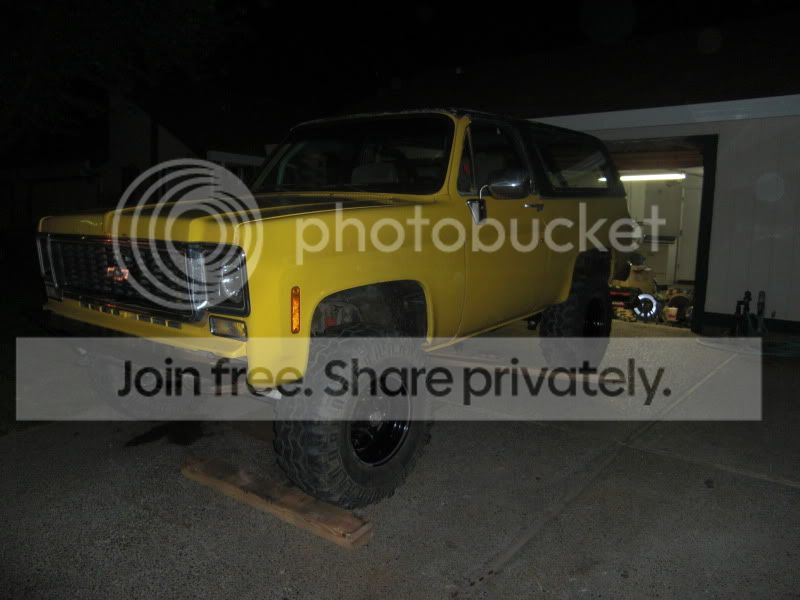

Also, here's a truck I had with a 4" lift and 35" MT/Rs. Only required a little trimming to fit them at full stuff. Didn't need to trim them for on road driving. No Sway bar.
