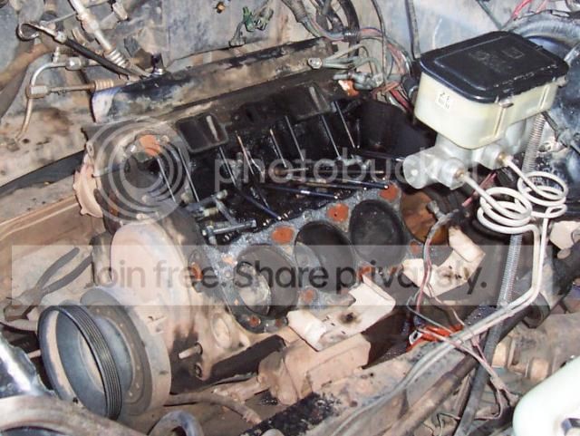

Yes I believe there is a magnetic drain plug. I'm not hearing any other odd noises coming from the valvetrain, other than the tick. The Avalanche had a bad roller wheel a few years back and wiped out the cam lobe, that was a very distinct sound.
From the Avalanche...
This made a weird chirping type of noise, never heard any ticking from this one.

Also, that roller was definitely messed up, but you caught it before it seized up. I've seen them after a roller seized and it was a lot worse. Plus it starts ticking because it keeps getting shorter.
